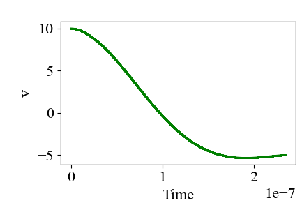

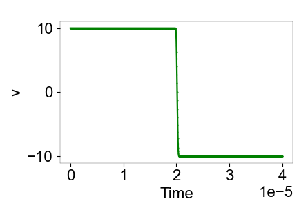

For the simulation, I fixed one atom and applied an initial velocity of 10 m/s to the other atom:
velocity nve_group set 0 0 10
From the simulation results, the collision time is 2.8e-7s, and the restitution coefficient (post-collision velocity/initial velocity) is 1.

Thank you for your reminder. It made me re-examine my model, and I found that I had some misunderstandings about certain parameters in my model: the second parameter of linear_history should be the multiplier for the normal damping. However, the issue still persists. In fact, the two definitions I am using are equivalent:
pair_style granular
pair_coeff * * hertz {kn} {gamman} tangential linear_history {kt} 0.5 0.5
by default damping = viscoelastic

But as mentioned above, when I take the following parameters:
kn kt gamma_n gamma_t
36630036630 45248868778 95468 47734
The calculated result of the equation is e=0.5, while the simulated result is e=1.0

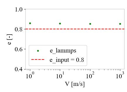

I noticed that the coeff_restitution model you mentioned allows specifying the restitution coefficient, and I have also tested this model. I found that it achieves the same restitution coefficient at different speeds, but the measured restitution coefficient is usually higher than the specified one. Is this normal?
damping coefficient
For the paper you cited, you might try contacting the authors to figure out variables.
For the coeff_restitution model, you might be getting a small shift because you’re only integrating one particle’s position which could affect dynamics. Namely, one particle effectively has infinite mass which is not accounted for in the calculation of the damping coefficient. There is an example script included in LAMMPS, examples/granular/in.restitution, which might be helpful to compare to.
