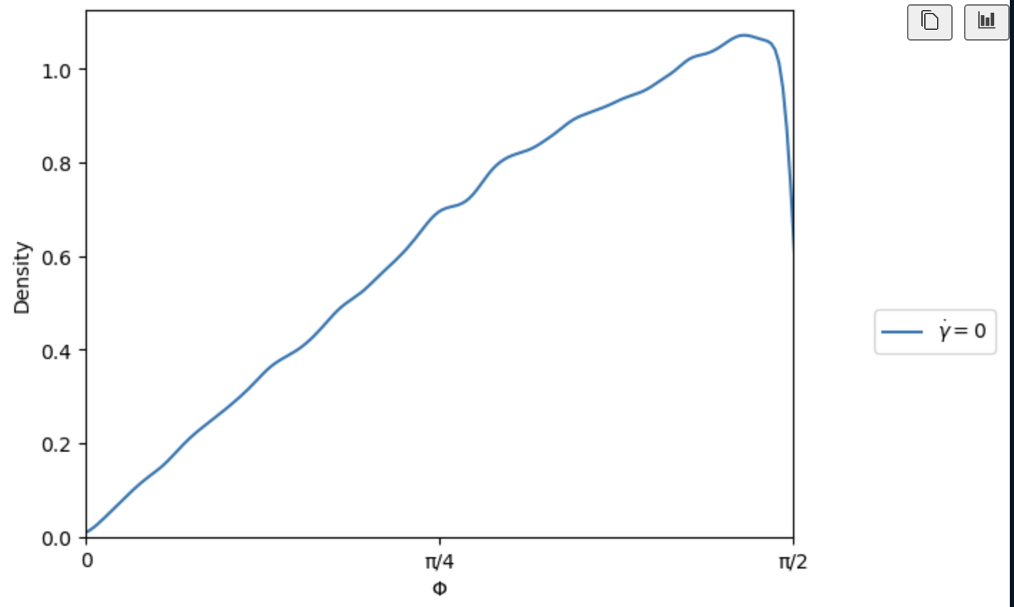

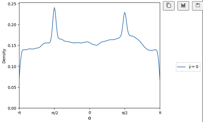

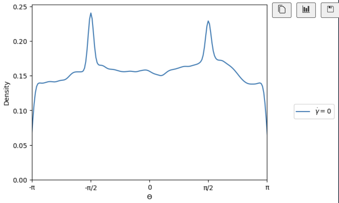

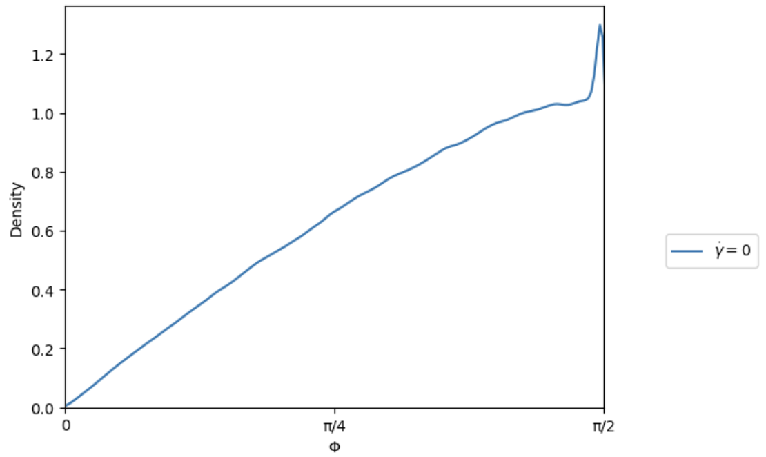

I understand, however when I run my simulation and calculate the orientations of the plates, I get the following distributions for theta(azimuth) and phi(inclination). I have shifted all orientations to sit in the upper hemisphere.
The peaks at pi/2 are the issue, causing the stress to become anisotropic, which should not be the case in equilibrium.

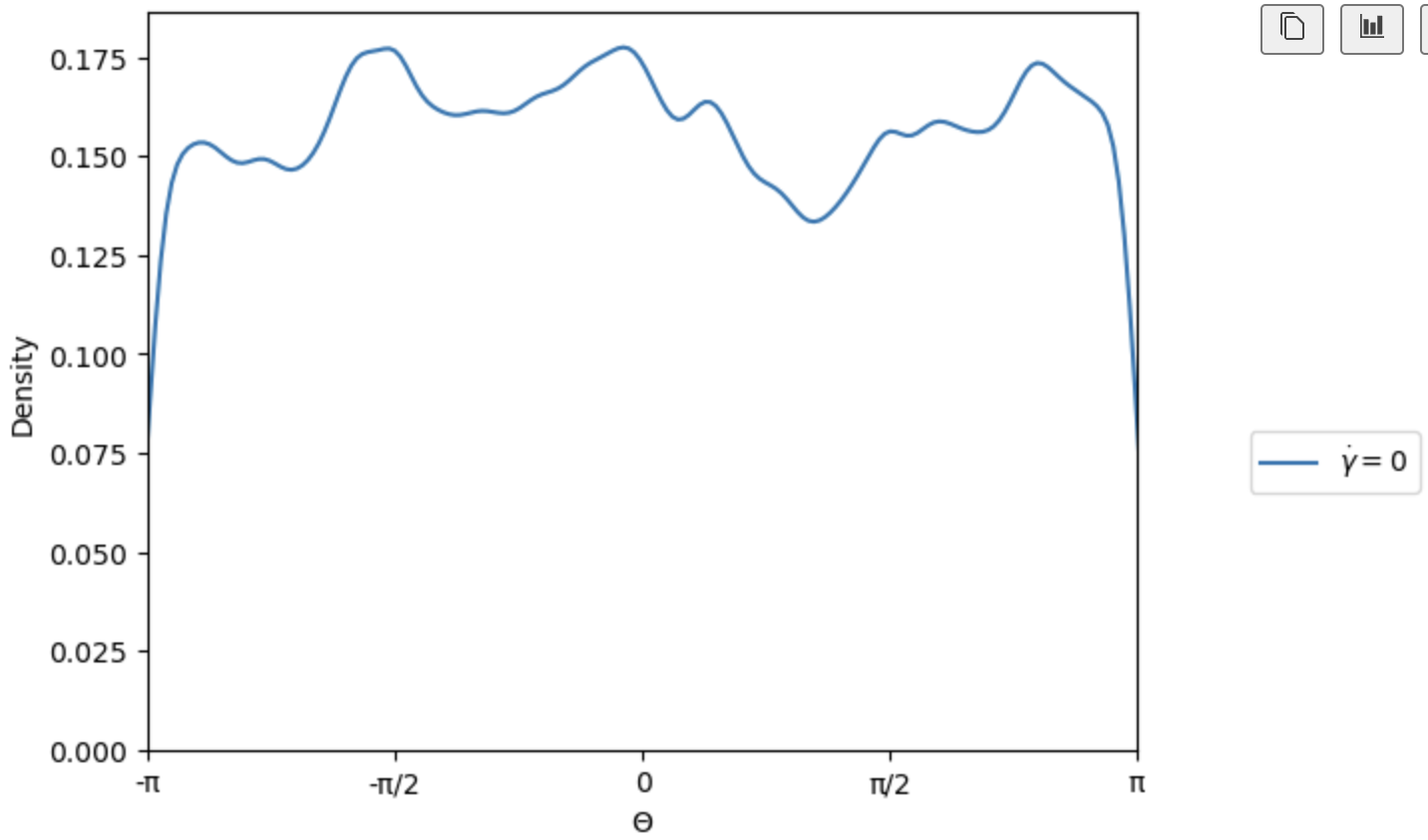

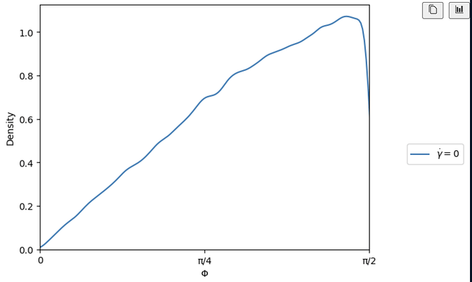

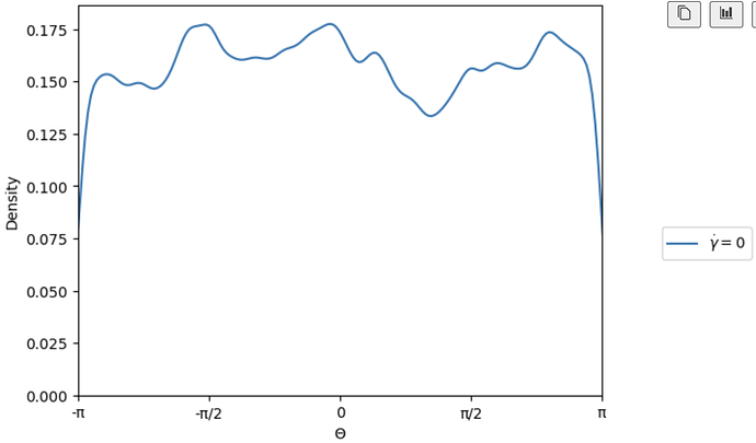

Update:
I ran the simulations for 10x longer and looked at the last 30% of the data and found that the system does reach the uniform distributions I expected:
At this point, I can equilibrate the simulation before applying my driving forces which will have the desired orientational distributions.

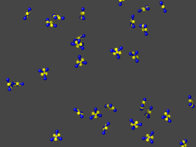

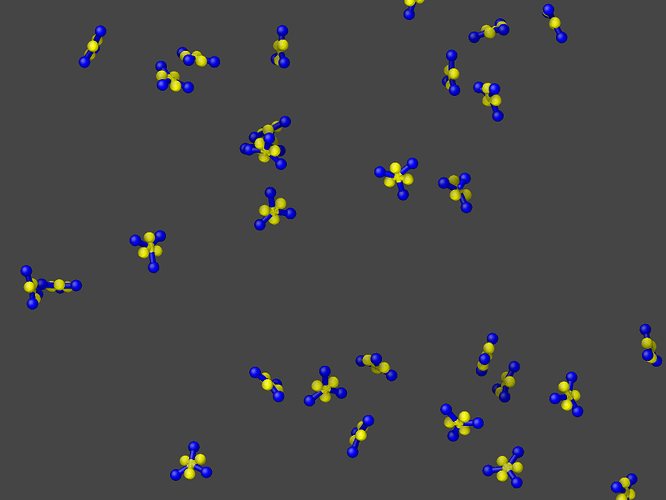

Thanks. I had a quick look and here is a snapshot made right after creating the particles.
Very obviously the different “molecules” have different orientations. Those are random, but not necessarily following a specific distribution. I don’t think that makes much sense with placing them also at random positions. You obviously must spend sufficient simulation time on equilibrating this.
Issues with pressure, assuming it is caused by particles being too close, can be reduced when using the overlap keyword of create_atoms random. I don’t think that there is anything else that can be done on the LAMMPS side. I cannot comment on the rest, since this is research too far away from from stuff where I have some experience.
