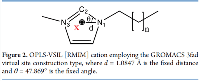

I wanted to model the RMIM cation with a virtual site introduced by Acevedo et al. (Doherty, B.; Zhong, X.; Acevedo, O., Virtual Site OPLS Force Field for Imidazolium-Based Ionic Liquids. The Journal of Physical Chemistry B 2018, 122(11), 2962-2974.), as shown below. In this model, a dummy atom (ε = σ = 0) carrying a negative charge was defined to offload the negative charge to inside the plane of the ring.
To do so, the N1-X bond and the C2-N2-X angle should kept fixed (rigid) during the simulations. I tested applying a large K value for bond and angle constants, but it didn’t work.

I wonder if the geometry might be suitable for you to apply the TIP4P styles, having N3-C2-N1 and X along its bisector. Otherwise, you can try fix shake or fix rigid/*/small to rigidify either the whole molecule or suitable subparts.

  • As mentioned in the original post and noted in the caption of Figure (d and theta are reported there), the LJ parameters for dummy X atoms are ignored. X carries a charge of -0.088 e. All other atoms are treated by an OPLS-style forcefield (of course, the combination rule would be geometric, etc.).
  • All other bonds and angles except the targeted N1-X and C2-N2-X are flexible (fix shake are applied to H-connected bonds)
  • All other atoms, including the surrounding N1 atom are charged (e.g., N1 carries a charge of +0.176 in this model)
