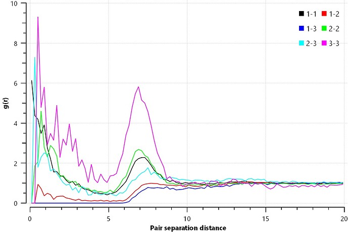

Hi, after obtaining the polymer model from moltemplate, I used fix deform to reduce the size of the box from (300, 180, 180) to (180 180 180). Following that, I hope to do NVT.
The protocol is to create a well-mixed polymer system (aka like a melt) for further simulation.
The problem is that my rdf, after 5,000,000 steps, looks like the one I uploaded.

Any suggestions on how to proceed?
