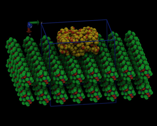

  • you are trying to plot the density profile in z-direction, but your layers are stacked in x direction (see image attached below).
Below is a visualization of your system as defined in the data file. A large part of it is outside the central simulation cell and will thus be wrapped back into the principal cell by LAMMPS when applying periodic boundaries. Please also note the axis labels.

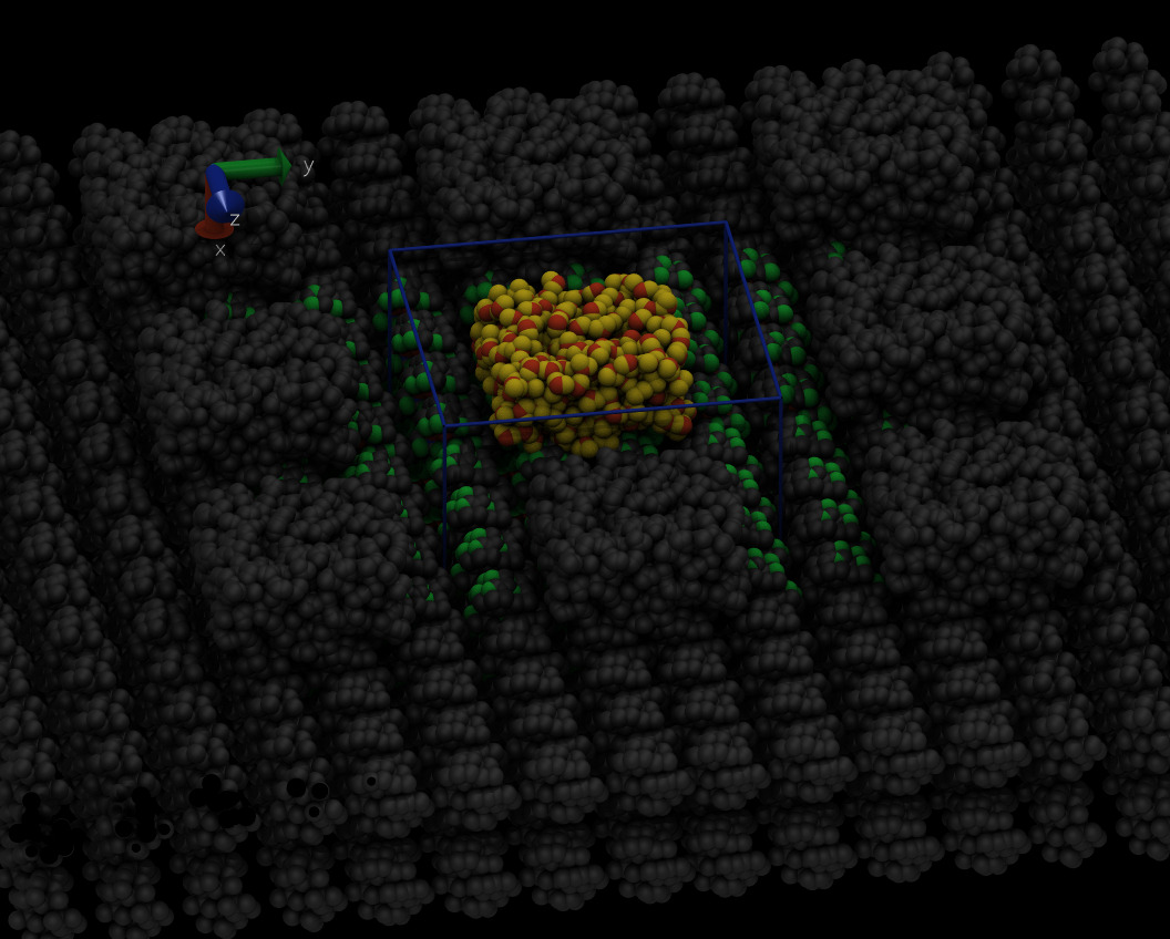

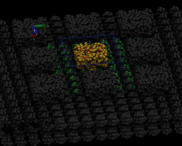

Below is a visualization with one level of periodic images added in x- and y-direction colored in gray. You can clearly see how this creates a very bogus geometry, which is the main reason why you have unphysically high energies and pressures in your system.
Not getting the density plot you expect should be the least of your worries. What does it matter, if your density plot does not look like you expect when you are plotting bogus data. Since the last time I commented on a message of yours, you have made zero progress on the fundamental problems of your simulation thus highlighting - again - how bad an idea it is to keep doing this without proper tutoring and training and without following the advice being given.
