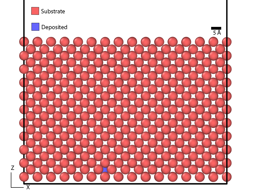

I tried moving the deposition region away from the surface like you suggested, but when I visualize with OVITO, I still get atoms being deposited in the bulk (towards the bottom of the block) for some reason. I also get a warning about particles being time-integrated multiple times, but that shouldn’t be the case? Is there something I’m missing about how groups work?

It looks like the groups may have some intersection, based on the number of atoms in each. 1125+2925+1125 (bulk+langevin+surface) = 5175, not 4175, so there’s overlap somewhere. Your lattice probably falls directly on z=2 or 8. That overlap would cause the integration error.
FWIW, the ambiguity of lattice positions on integer region boundaries can be easily avoided by either using non-zero non-integer values for the origin keyword with the lattice command or by using non-integer region boundaries.
