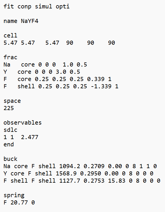

I have attached snippet of my input file.

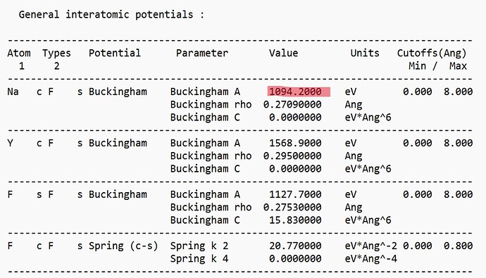

Here is the output before optimization.

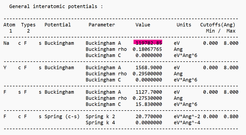

Here is the output after optimization.

I am optimizing the Buckingham potential parameters for a material system. However, when I attempt to optimize a single parameter (e.g., A, ρ, or C), the optimized value deviates significantly—by several orders of magnitude—from the expected range. Notably, the starting value for this parameter was already an optimized value obtained from GULP.
Despite this, the optimization process introduces large deviations. What could be causing this deviation? I would be grateful for any insights or suggestions you might have on troubleshooting this issue.
