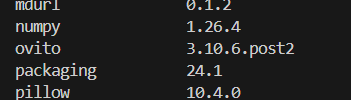

My ovito version is 3.10.6.
This is the version of ovito library:
