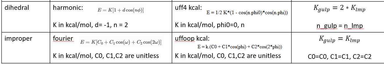

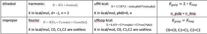

this is functional forms in LAMMPS and GULP:
the coeffs in lammps is
Dihedral Coeffs
1        6.737110              -1               2 # Cu4+2 O_2 C_R O_2
2        3.368555              -1               2 # H_ C_R C_R C_R
3        1.250000              -1               2 # C_R C_R C_R O_2
Improper Coeffs
1        2.000000        1.000000       -1.000000        0.000000   # H_ C_R C_R C_R
and what I set in GULP is:
uff4 bond kcal
Cu O C3 O 13.47422 2
H C1 C2 C3 6.737110 2
C1 C2 C3 O 2.500000 2
uffoop bond kcal
C1 H C2 C2 2.000000 1.000000 -1.000000 0.0
this is my full gin file
single.gin (11.2 KB)
and the asymmetric unit is:
I didn’t see anything wrong in gulp settings, and can anyone spot any mistake in these two parts of the input file?
