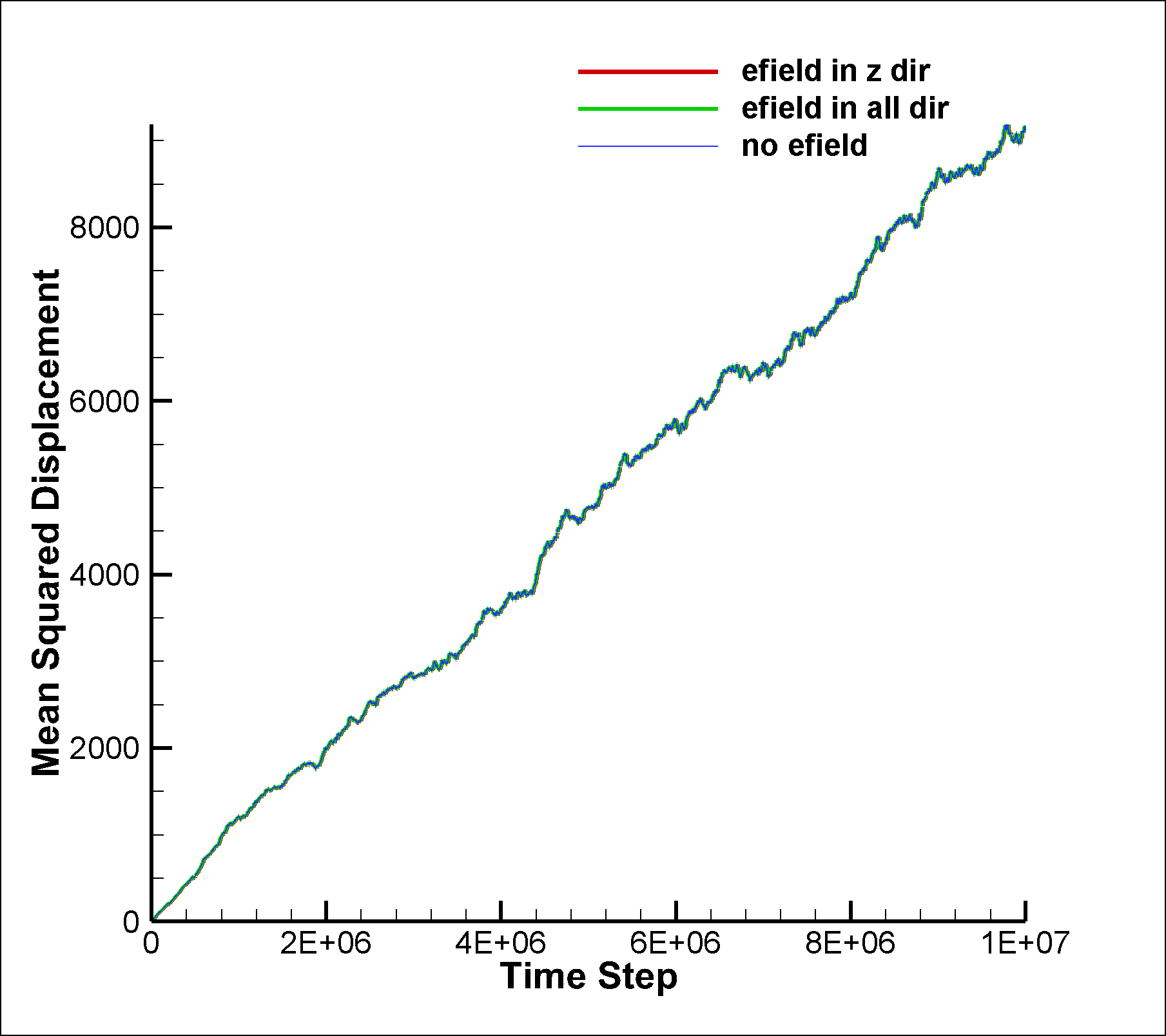

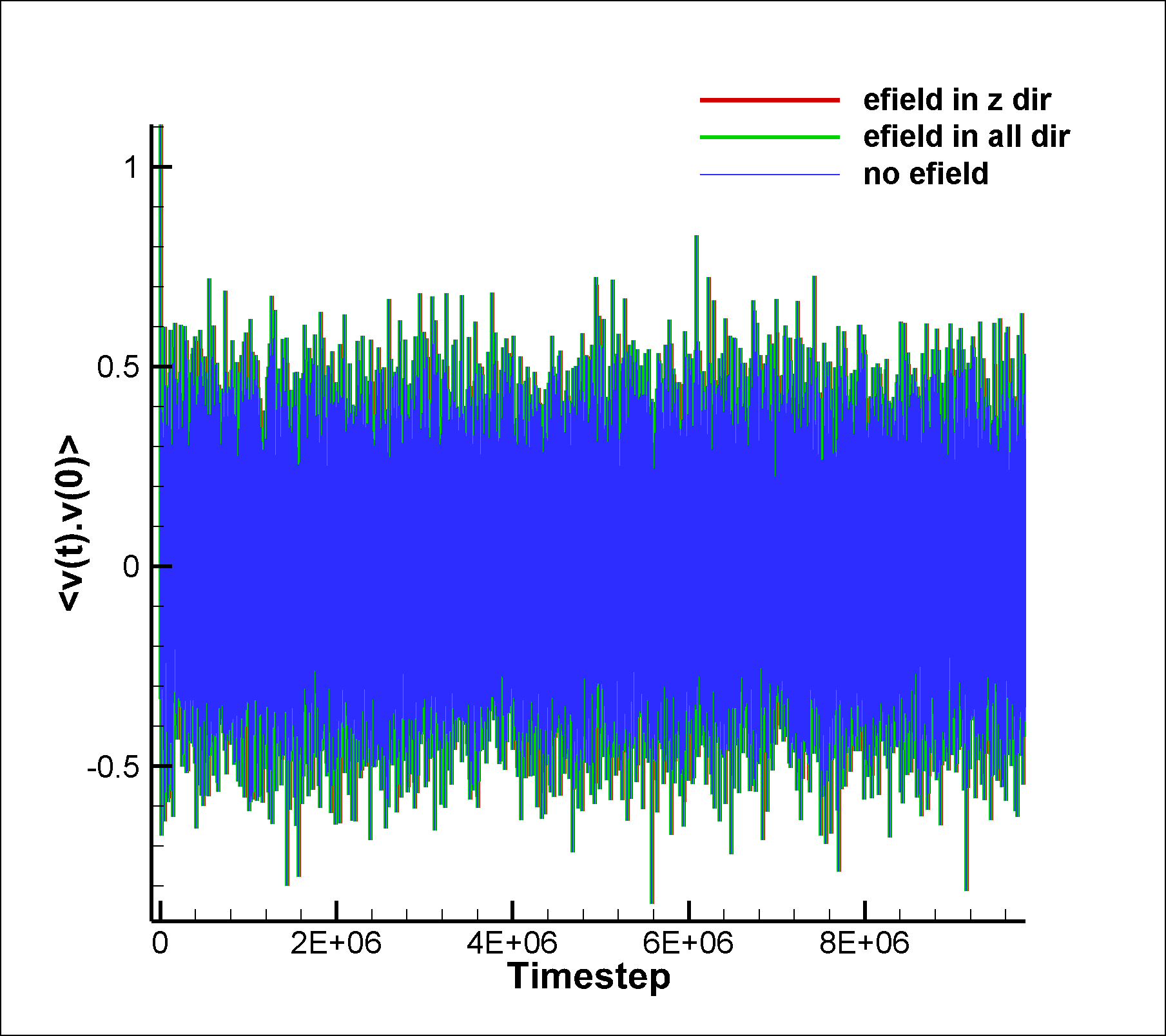

I am attaching two input scripts, one with a mixture SRD of style charge (initial charge set to 0.0) and the other with a net dipole of 1.0 (in reduced lj units). I expected to see an effect due to electric field on the system in the case of dipole, but I am not able to observe any difference between the results of the two runs. I am also attaching the graphs for vacf, msd and diffusion coeffcient calculated using msd.
I have used fix efield, but I am not sure if it is being called?
Any advice please?

as the fix efield documentation states, fix efield adds a torque to
particles with a (point) dipole.
however, there is nothing in your input, that is in any way reacting
to this torque (or to the dipole outside of fix efield).
