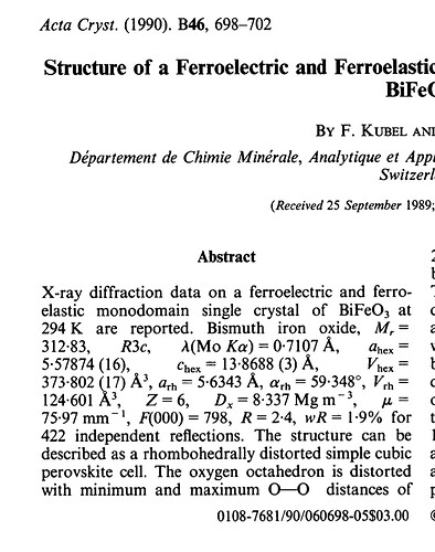

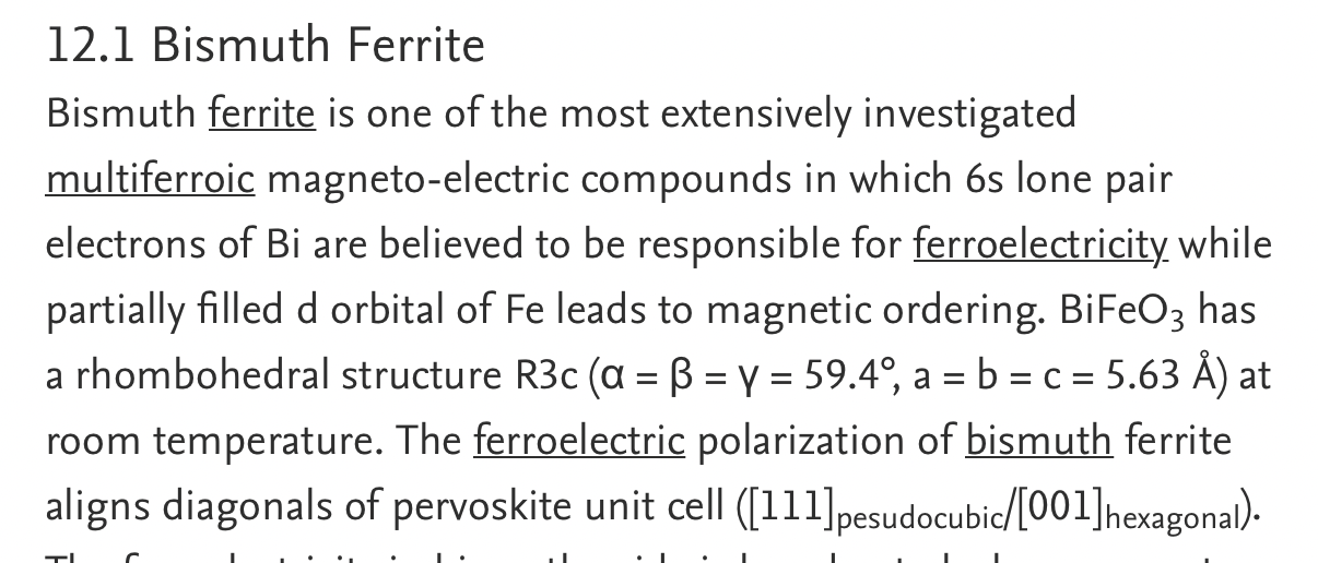

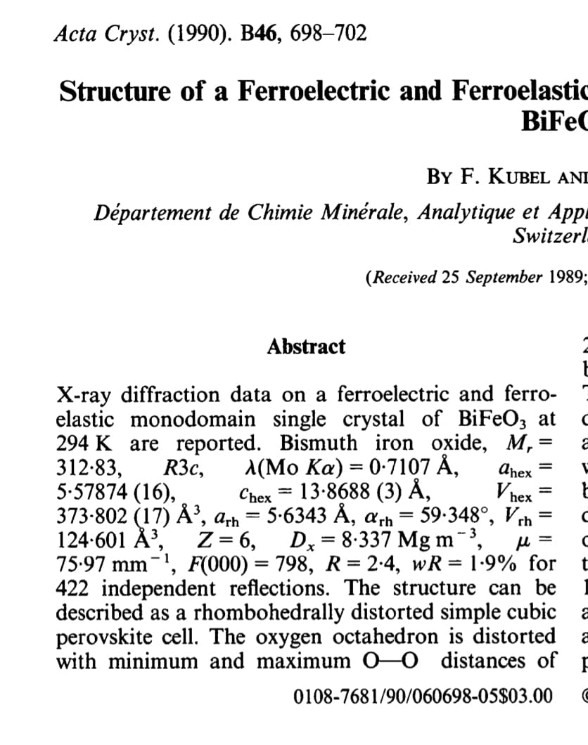

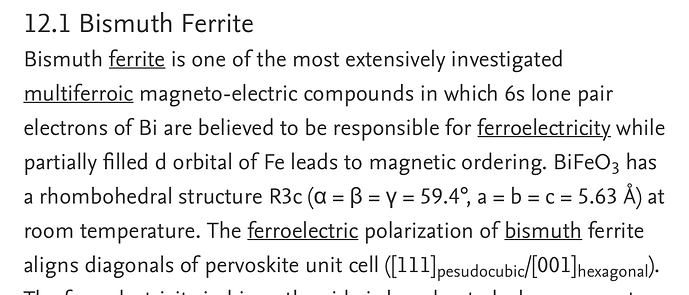

Difference on the lattice parameter of BiFeO3 between the reported values in papers and the calculated values in materials project
Seems like your original reference is just wrong about the structure? Even the original source the paper you linked cites says a_rh = 5.6Å, and other sources agree with that.
