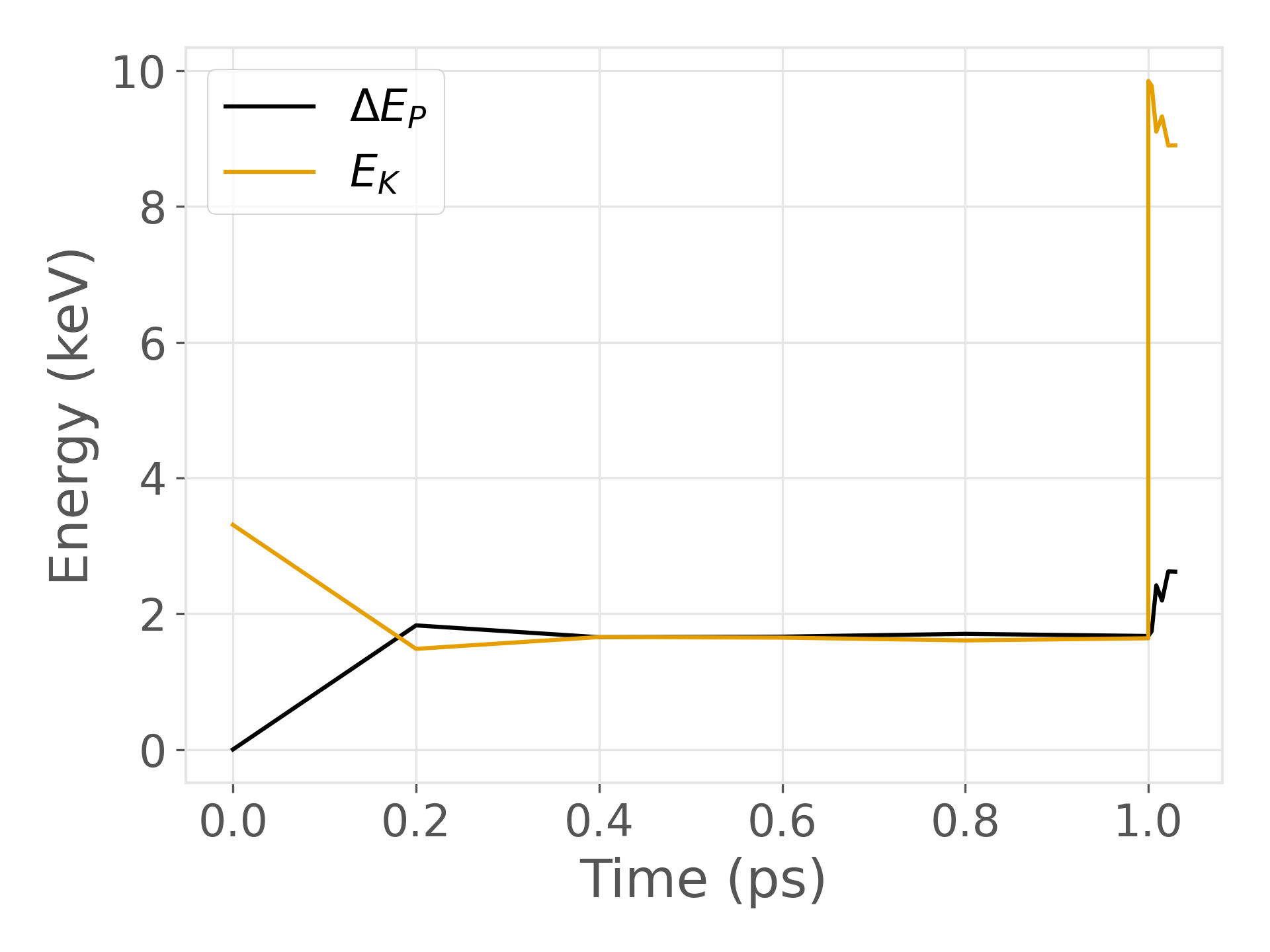

And this is the energy evolution (kinetic energy and potential energy minus initial potential energy) from log.lammps:
You can see that the thermalisation takes place correctly, but when the PKA is boosted, the energy increases around 8 keV.

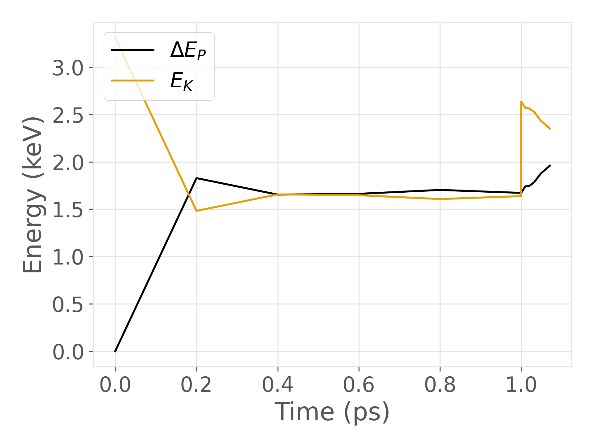

The jump in the kinetic energy is 1 keV as expected.
Why are these results different? Maybe it is related to units?
The restart file does not contain information about the lattice and velocity command uses lattice units by default.
Below I’m attaching a simple script which shows this.
units           real
region          u sphere 0 0 0 10
create_box      1 u
mass            1 10
lattice         fcc 4
create_atoms    1 box
thermo_style    custom ke
write_restart   test.restart
velocity        all set 1.0 0 0
run             0 post no
clear
read_restart    test.restart
#lattice         fcc 4 #uncomment to get the same KE
run             0 post no
Then velocity PKA set 587.92 0.0 0.0 units box solved the issue.
