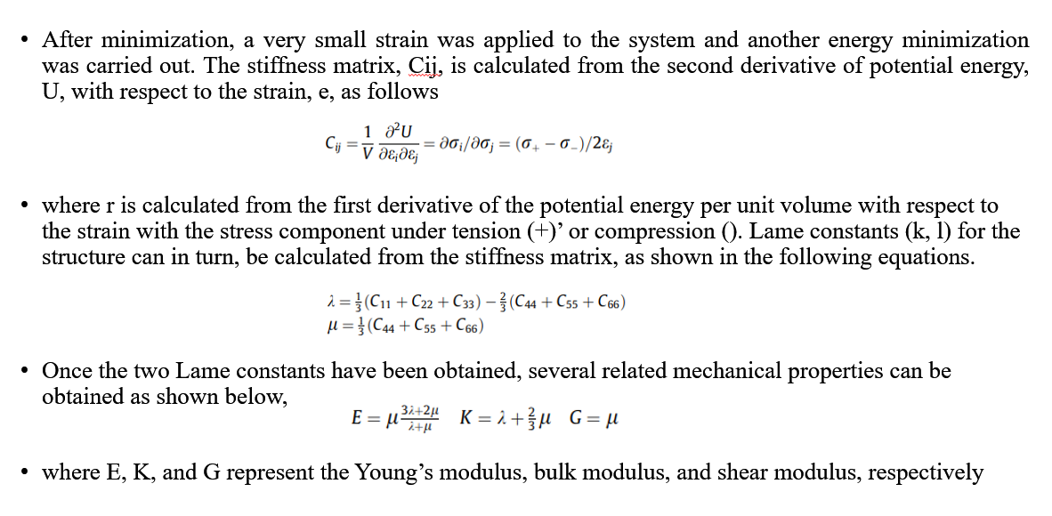

To calculate the elastic constant of polymer composite, a constant strain minimization method I want to use.
can we apply this method in LAMMPS ?
