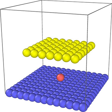

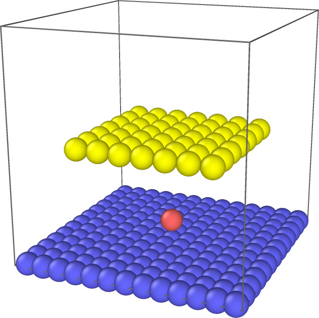

Here is my script that can reproduce what I want to do
units lj
atom_style full
atom_modify map array
region box block -5 5 -5 5 0 10
boundary p p f
create_box 3 box bond/types 1 extra/bond/per/atom 5 extra/special/per/atom 50
# --- reaction site ---
create_atoms 1 single 0 0 1
mass 1 1.0
# --- setup wall ---  type 1
region wall block INF INF INF INF 0.0 0.5
lattice sc 2.0
create_atoms 2 region wall
mass 2 1.0
region antiwall block -3 3 -3 3 5.5 6.0
create_atoms 3 region antiwall
mass 3 1.0
fix zhiwalls all wall/reflect zhi EDGE
# --- potential setup ---
pair_style lj/cut 2.5
pair_coeff 1 3 1.5 1.0 2.5  # particle & reaction site
pair_coeff * * 1.0 1.0 1.0
pair_modify shift yes
bond_style fene
special_bonds fene
bond_coeff * 30.0 1.5 1.0 1.0
timestep 0.002
minimize 1.0e-5 1.0e-6 100000 1000000
group reactionSite type 1 dynamic all every 1  # wrong!
group surface type 2
group particle type 3
velocity particle create 1.0 74982687
fix 1 particle nve
fix 2 particle langevin 1.0 1.0 1000 12345
fix 3 all bond/create 1 1 3 1.0 1 jparam 1 1  # turn
dump  obs all custom 10 big.dump id type q x y z
run 10000

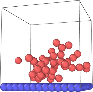

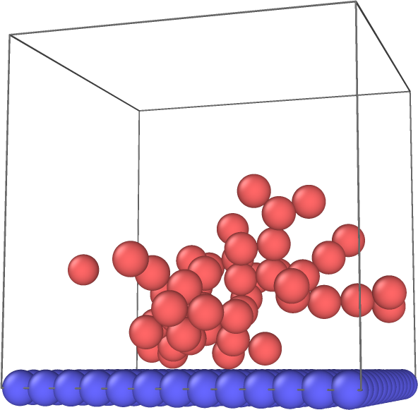

before:
after:
