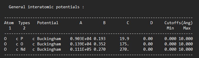

Hello, Julian! I’ve also encountered a problem—I’m not getting the correct accuracy for the potential parameters when outputting GULP (I’m not sure how much error is introduced by rounding). Could you please tell me how I can increase the number of decimal places (or change the output from exponential to numeric) without editing the internal files? I’m using GULP version 4.0.1.
Hi Stalminer. The important point here is that there is no rounding error or loss of accuracy because the output of parameters is rounded in the output file. Everything has the same precision as your input file (within the limits of double precision). If you want to see more numbers in your output then the solution is simple - just upgrade your old copy of GULP to any version from 5.1 onwards (current latest is 6.3) and the format of the output for potentials was changed to allow more digits to be shown. Regards, Julian
