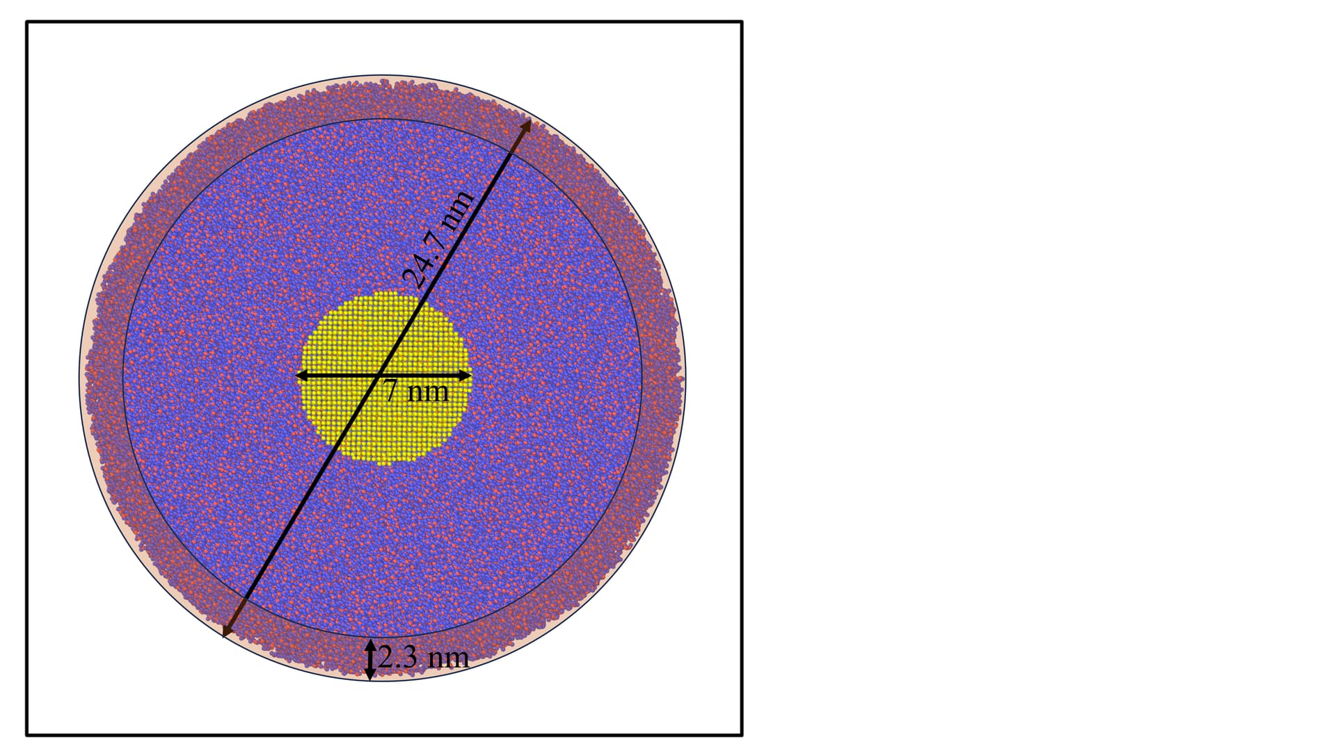

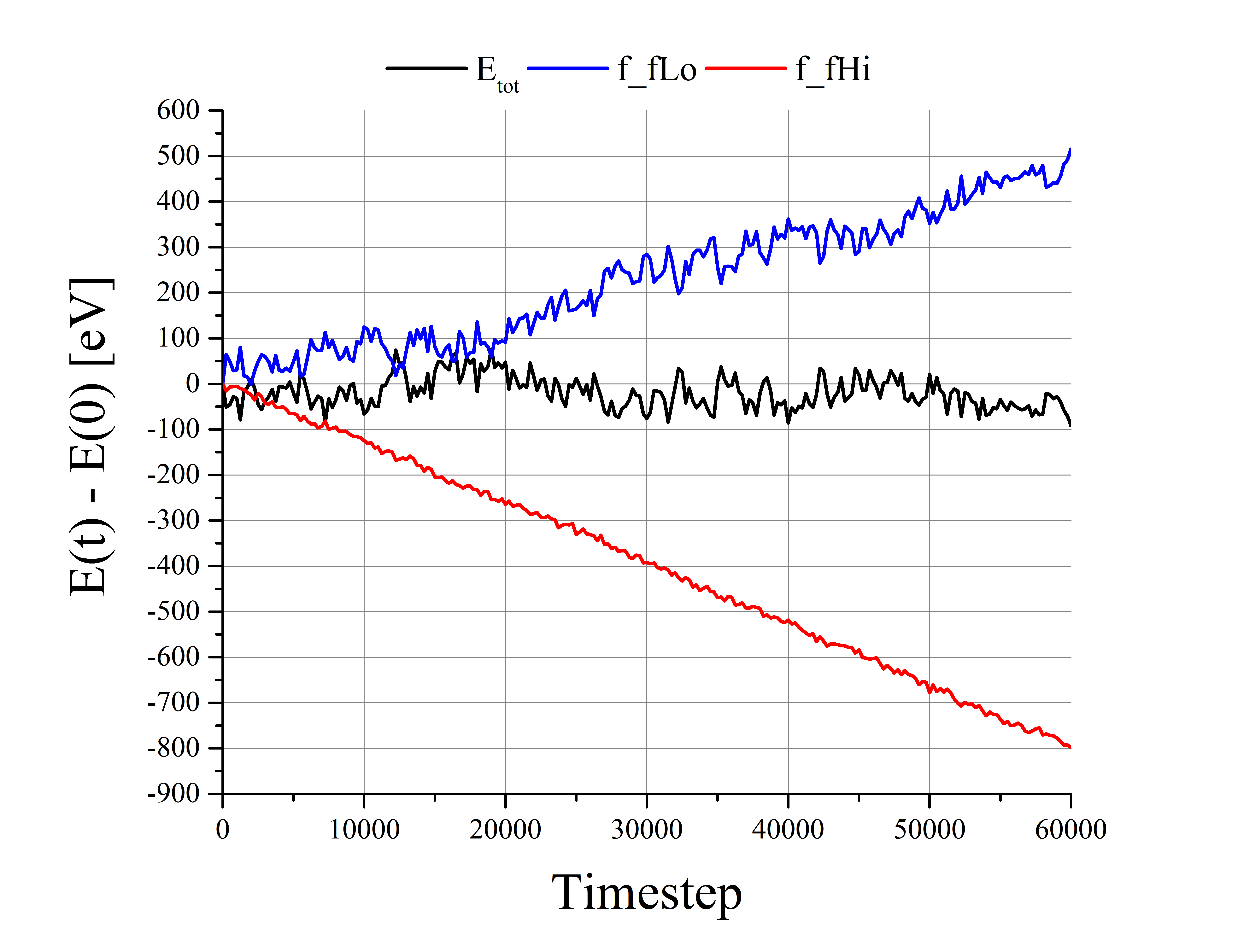

I am unsure if this question relates to LAMMPS or general Physics. I have two thermostatted groups, one of each is gold (“hot region”) and the other one contains water (“cold region”). The “hot region” is maintained at 350 K while the “cold region” is maintained at 300K with Langevin thermostat. I have no overall energy drift in the system, but the absolute values of energies deposited by the thermostats into corresponding groups differ by about 60%. If this energy goes into, let’s say, rotation of the system as a whole, shouldn’t it be reflected in the total energy change? Right now it looks like the thermostats should be pumping energy into the system based on their net cumulative energy change, but this doesn’t seem to be reflected in the total energy. I appreciate any suggestions!
The computational setup is a spherical shell of SPC/E water surrounded by a 12-6 Lennard-Jones wall (wall/region with lj126). The “cold region” is ~ 2.3 nm thick and is shown by the orange color in the snapshot below. The snapshot is a slice of the whole system. The gold atoms are shown in yellow and the water atoms are shown in red and white. The graph demonstrates the total energy change of the system (Etot) relative to t = 0, the cumulative energy change for the hot thermostat (f_fHi), and the cumulative energy change for the cold thermostat (f_fLo).

It should not. Please see the following statement from the fix nvt documentation:
The cumulative energy change in the system imposed by these fixes, via either thermostatting and/or barostatting, is included in the thermodynamic output keywords ecouple and econserve. See the thermo_style page for details.
So etotal does not account for the energy that was added to or removed from the system by the thermostat, but econserve does. While the cold part has to remove energy, the hot part has to add it and the sum of potential and kinetic energy of the whole system should be constant when the system is in (dynamic) equilibrium.
