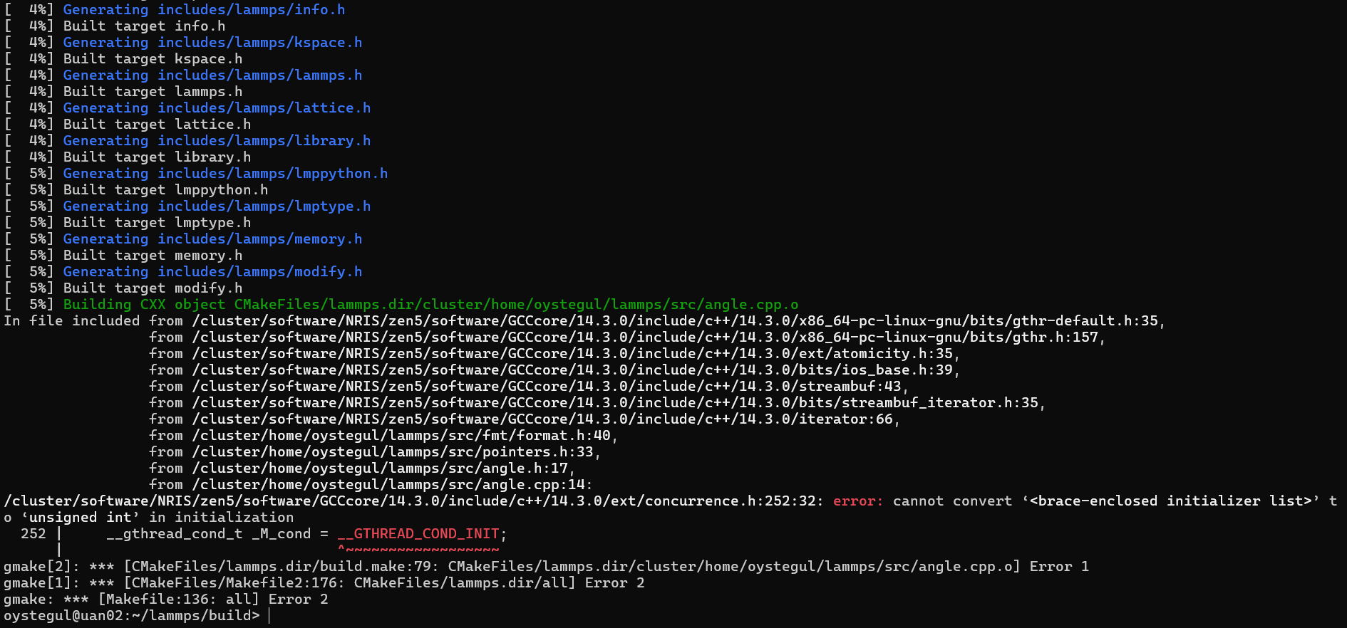

We have recently been given access to a new supercomputer here in Norway, Olivia — Sigma2 documentation. When I try to compile the latest release of LAMMPS (patch_10Sep2025) on it using GNU 14.3.0 I get an error almost immediately,
error: cannot convert ‘<brace-enclosed initializer list>’ to ‘unsigned int’ in initialization :
[ 5%] Generating includes/lammps/lmptype.h
[ 5%] Built target lmptype.h
[ 5%] Generating includes/lammps/memory.h
[ 5%] Built target memory.h
[ 5%] Generating includes/lammps/modify.h
[ 5%] Built target modify.h
[ 5%] Building CXX object CMakeFiles/lammps.dir/cluster/home/oystegul/lammps/src/angle.cpp.o
In file included from /cluster/software/NRIS/zen5/software/GCCcore/14.3.0/include/c++/14.3.0/x86_64-pc-linux-gnu/bits/gthr-default.h:35,
from /cluster/software/NRIS/zen5/software/GCCcore/14.3.0/include/c++/14.3.0/x86_64-pc-linux-gnu/bits/gthr.h:157,
from /cluster/software/NRIS/zen5/software/GCCcore/14.3.0/include/c++/14.3.0/ext/atomicity.h:35,
from /cluster/software/NRIS/zen5/software/GCCcore/14.3.0/include/c++/14.3.0/bits/ios_base.h:39,
from /cluster/software/NRIS/zen5/software/GCCcore/14.3.0/include/c++/14.3.0/streambuf:43,
from /cluster/software/NRIS/zen5/software/GCCcore/14.3.0/include/c++/14.3.0/bits/streambuf_iterator.h:35,
from /cluster/software/NRIS/zen5/software/GCCcore/14.3.0/include/c++/14.3.0/iterator:66,
from /cluster/home/oystegul/lammps/src/fmt/format.h:40,
from /cluster/home/oystegul/lammps/src/pointers.h:33,
from /cluster/home/oystegul/lammps/src/angle.h:17,
from /cluster/home/oystegul/lammps/src/angle.cpp:14:
/cluster/software/NRIS/zen5/software/GCCcore/14.3.0/include/c++/14.3.0/ext/concurrence.h:252:32: error: cannot convert ‘’ to ‘unsigned int’ in initialization
252 | __gthread_cond_t _M_cond = __GTHREAD_COND_INIT;
gmake[2]: *** [CMakeFiles/lammps.dir/build.make:79: CMakeFiles/lammps.dir/cluster/home/oystegul/lammps/src/angle.cpp.o] Error 1
gmake[1]: *** [CMakeFiles/Makefile2:176: CMakeFiles/lammps.dir/all] Error 2
gmake: *** [Makefile:136: all] Error 2

Hi Oystein (: I notice the compilation seems to be using GCC 14.1.0, but the CMake output you listed seems to point to an Intel MPI C++ wrapper instead.
In such situations I often just delete the build folder and CMake from scratch again.
The error is originating from the compiler installation itself and not from LAMMPS. I suspect that the problem is due to the compiler installation or other, related issues, e.g. incompatible environment modules or similar.
You can try narrowing it down by configuring/compiling with -D BUILD_MPI=OFF and -D BUILD_OMP=OFF and no packages or only the basic set with -C cmake/presets/basic.cmake. If that is successful, you can enable packages in stages, and see which is causing trouble and then enable MPI and OMP, or the other way around.
Thanks both @srtee and @akohlmey!
You are correct about the mismatch of compiler and CMake output. That can happen sometimes when you start to try every single available compiler. I deleted the build folder, remade it and cmake’d from scratch but I still get the same error.
Then I tried to compile by cmake -C ../cmake/presets/all_off.cmake -D BUILD_MPI=OFF -D BUILD_OMP=OFF ../cmake - but still get the same error.
Now I am unsure of what to try next, any suggestions?
That suggests the selected compiler module is broken and you need to select a different one. Overall, try loading only the minimum set of environment modules.
Yes, this worked! Apparently some special software stack had to be used. Thanks a lot!
