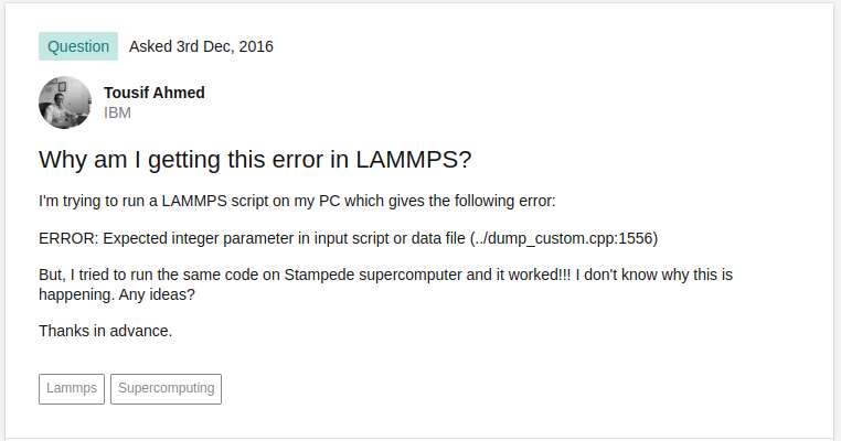

My Lammps version is June 23, 2022. I have uploaded the input file and.dat file (GitHub - BrokenHeart2021/Lammps-test), which is an equilibration process. I conducted it on my PC and got that error. I know one also has this problem shown in the attachment picture. Maybe it is caused by PC; I have no idea about it. I will try to conduct it on a supercomputer.
