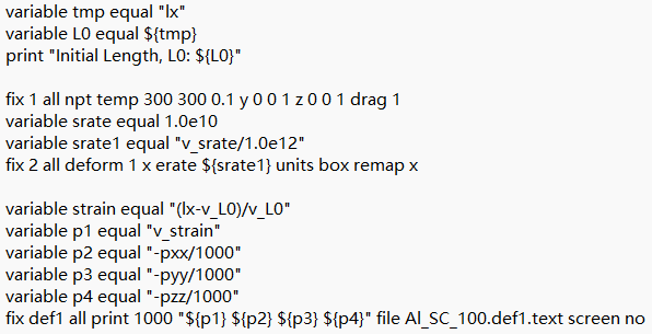

Thank you for answer! I have entered the correct double quotes already.

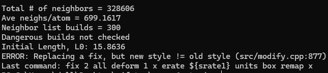

There is a new peoblem.
1724311111640(1)
1724311137643(1)
I dont know if it is the problem that i mentioned before which has 4 arguments not 3, or fix 2 has some problems.
This unreadable, please read the forum guidelines and learn how to correctly quote input file
This is a different problem. Just read the error message and study the LAMMPS documentation
