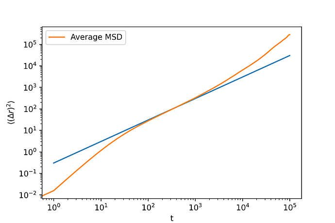

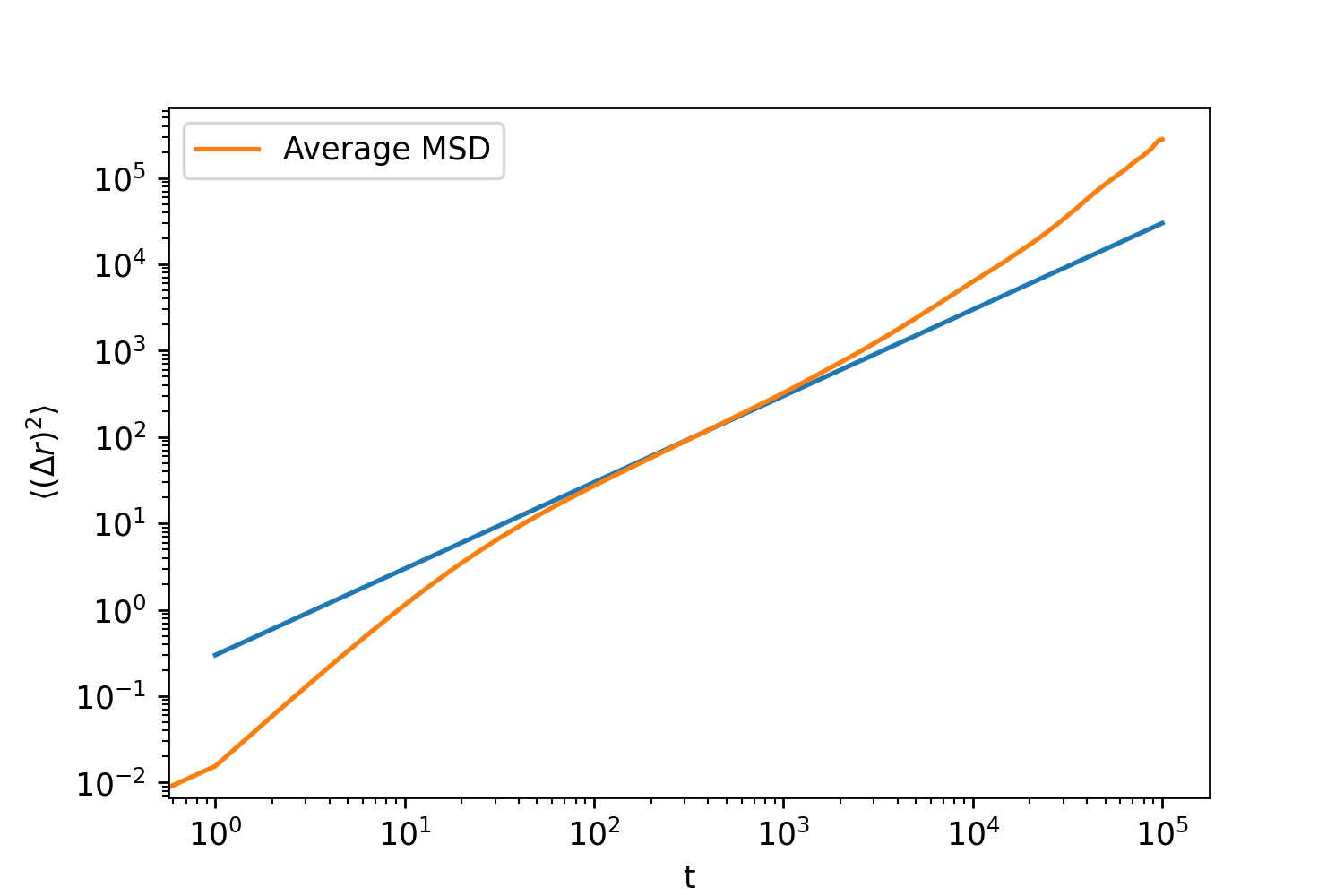

When I plot the mean squared displacement (MSD) as a function of time (t), I observe superdiffusive behavior at longer time, which is unexpected for this setup—I should be seeing normal diffusive behavior.
Interestingly, when I run LAMMPS continuously (without using loops and restart files), I observe the expected diffusive behavior.
I have checked my simulation parameters carefully and ensured consistency between the looped and continuous setups, but the discrepancy persists. Could the use of restart files in a looped setup introduce subtle errors, or is there something else I might be overlooking?
