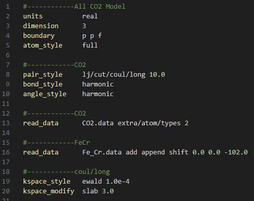

when I made a model that CO2 is on the upper area and FeCr alloy is on the bottom area, I chose lj/cut/coul/long for CO2, for kspace_style chose ewald. I view the manual, didn’t find any mistake, but I got this error:
ERROR: KSpace style is incompatible with Pair style (src/kspace.cpp:199)
Last command: write_data data.CO2_FeCr
Follow is my in file.
Could anybody help me to solve this? Thank you so much!
Please quote the complete input file and not a screenshot (how rude).
You most likely have defined another pair_style after line 20, which overrides the previous command and does not include any long-range electrostatics.
Thank you for your reply! Yes, I defined another pair_style. I add the all data again.
All_model.lmp (922 Bytes)
