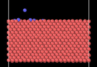

I do have wall/regions with LJ interactions involved in the simulation that could be causing the issue, but I was surprised that depositing atoms without initial velocity was still causing lost atoms. Here is an image of the setup I am trying to achieve:
where the yellow lines are the boundaries for the barriers. This image is a snapshot of a case where I was adding atoms with velocity.

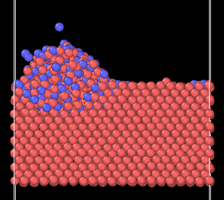

Here are the last snapshots of the structure before it loses an atom (snapshots collected every 100 timesteps):
With initial velocity @ 901300 timesteps
With some with initial velocity, and some without initial velocity @ 12500 timesteps
Both have wall/region LJ.
This error only started happening after adding in the walls. I just had a new thought that it may be because the new atoms are depositing too close to the walls since the edge of the deposition region and the walls were only 0.1 A apart. I’ll try increasing the distance to 2A and see if that is what is causing the issue.
Thanks for following up. From your snapshots, it appears that strong overlaps may be causing the issue.
