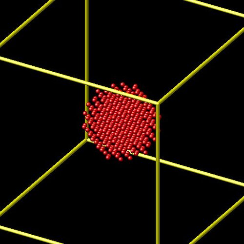

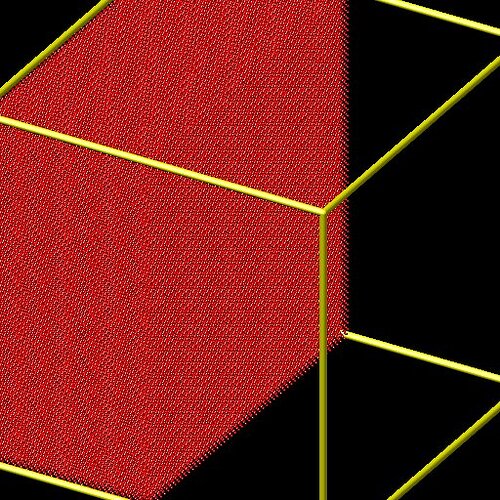

Now, if I modify the code to only view the nickel surface, I get:
And now, only the copper surface:
