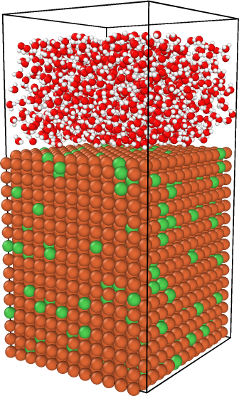

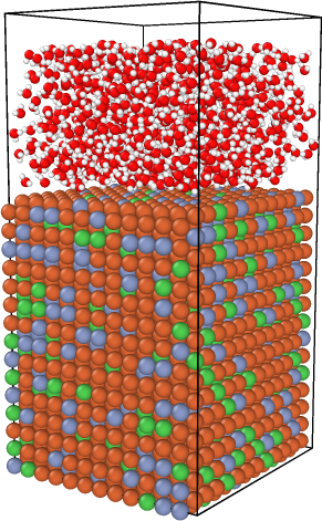

Dear Lammps Developer and users,
I’m using reaxff and there is no other difference in the geometry file other than the atom type. I have just substituted few of the Fe atoms with Cr atoms. The simulation works perfectly for Fe+Ni atoms but gives me Non-numeric atom coords error for Fe+Ni+Cr system. How can I solve this, since I believe that geometry is not the problem here. I have also checked for overlapping atoms. My options here were to play with the bin size, frequency of build-up, timestep size in the input script. I have tried all but nothing helped.

I’m not sure about it. I obtained this parameters from Dr. van Duin. I tried to work on system which was 9 times smaller than this one, which is 400 metal atoms reacting with 100 water molecules. It does work for smaller systems.
