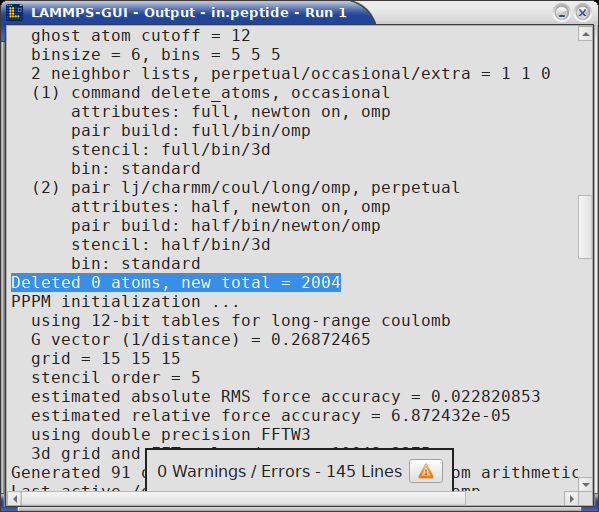

Here are two suggestions for what I usually do to make some simple assessments of a system.
Before the first minimize or run command, I insert the commands:
delete_atoms   overlap 0.5 all all
compute        pe all pe/atom
run            0 post no
quit
Then I load the input into LAMMPS-GUI and run it (very quick since there is only one step)
and look at the log file for a line talking about deleted atoms:
No deleted atoms here, thus no problem (after all it is a pre-equilibrated example from the LAMMPS examples folder).

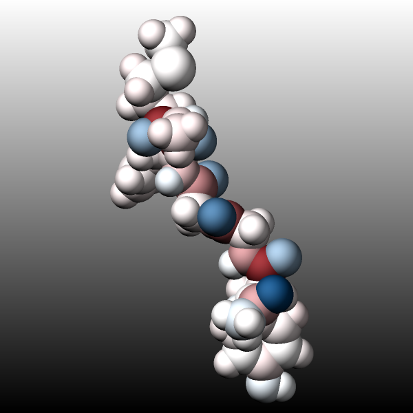

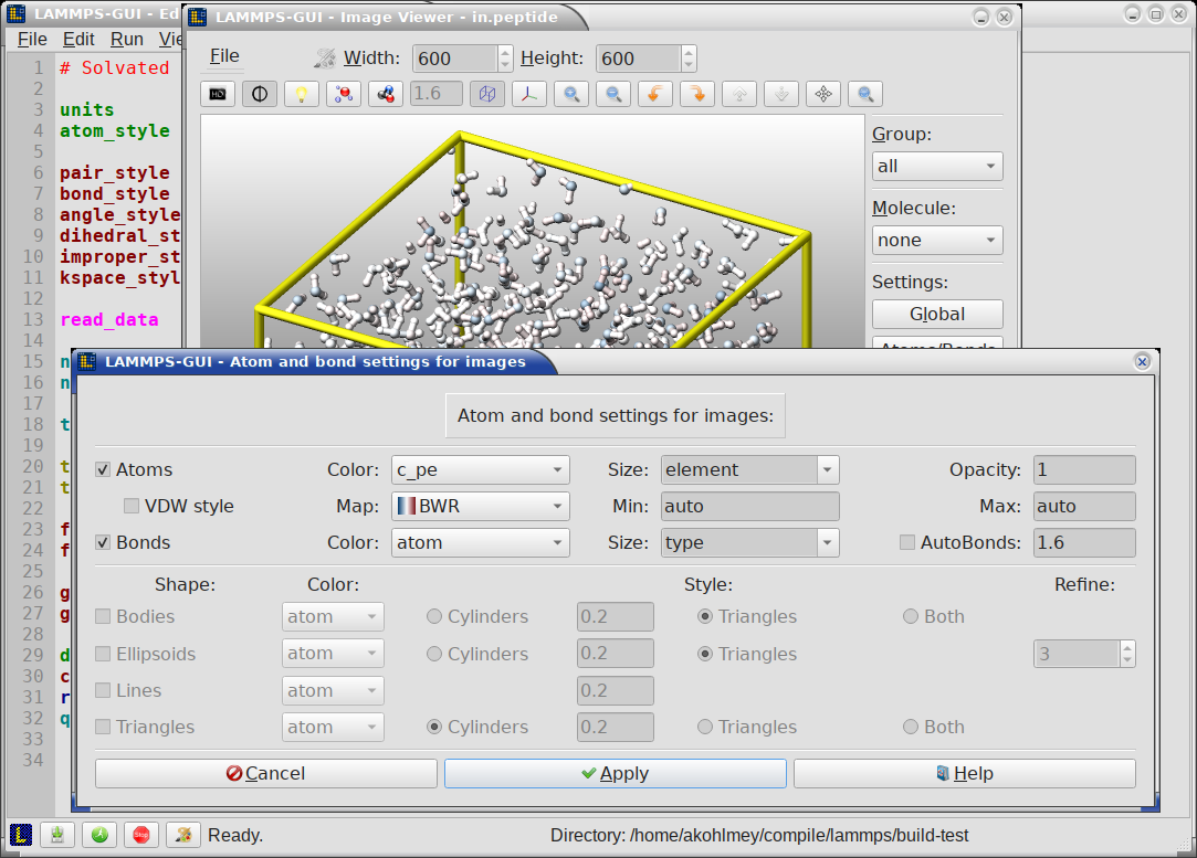

Then I open the ImageViewer window and open the Atoms/Bonds dialog to select coloring of the atoms by the pe/atom compute “c_pe”. Most of the (water) atoms have average potential energy, so no problem there either.
Finally, I tell it to render only the atoms in the peptide group and zoom in a bit.
Since this uses a blue-white-red map (BWR) the blue atoms have the lowest potential energy and the red atoms the highest. The latter are backbone atoms, which makes sense and this also looks all good. If you had some “hotspot” in your geometry, you would see it. Since you can tell compute pe/atom to selectively only show the potential energy for either non-bonded, bonded, or kspace interactions, you can also track down where specific issues are. E.g. with some bad bond topology data, you may have very high bonded potential energy.
