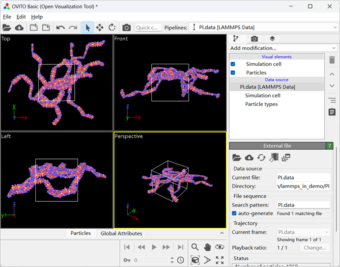

What I’ve done is pyrolytic PI films to simulate laser production of graphene, and the force field is ReaxFF Force field, using a version of LAMMPS 64-bit 2Aug2023-MSMPI for windows. However, an error was reported at runtime.

My modeling was done using Material studios software, converted into data files using msi2lmp program under pcff force field. The vmd software is then used to change the atomic type into charge. Here is the data file and its corresponding OVITO image.
