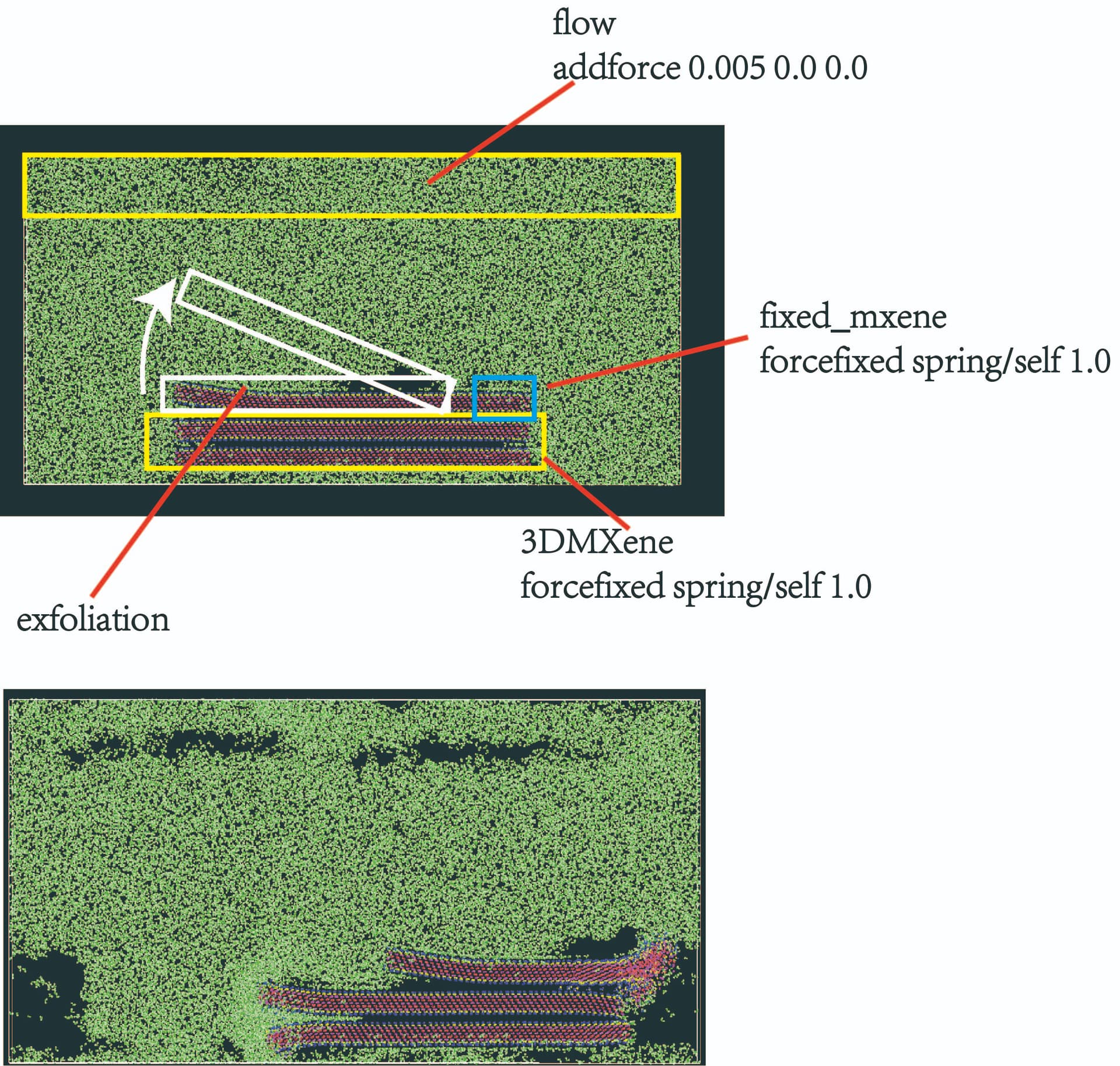

I am trying to exfoliate a 2D MXene sheet using water flow with the ReaxFF force field. After full NVT equilibration, I began the exfoliation step as shown:
  1. I used fix spring/self 1.0 to restrain the 3D MXene ,fixed mxene and prevent them from sliding.
  2. I applied a force to the water (group “flow”) to drive its flow.
  3. I expected the flowing water to peel off the 2D sheet inside the white box in Figure 1.
However, after running (Figure 2), the 2D sheet in the white box did not exfoliate, and the bonds in the spring‑fixed 3D region (blue box) became distorted.

The figures suggest that there is no or insufficient equilibration. Specifically the formation of significant vacuum bubbles are a very bad sign.
