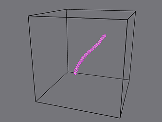

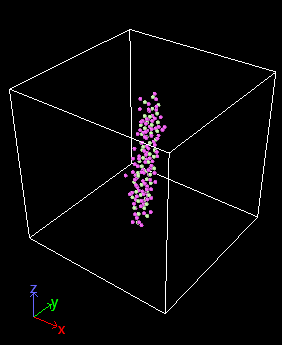

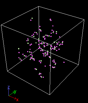

I am trying to run a short simulation of polyethylene in a NVT ensemble.
Problem is that PE molecule keeps exploding right after when the simulation starts.
I used a moltemplate example file to model PE. (COMPASS force field)
Code shown below is the LAMMPS code for the simulation.
I would like to know what is the cause of explosion and hopefully, solution too.
Thank you.

I don’t see anything in your LAMMPS input that would justify such an explosion. I can only assume that the issue must be originating from the parameter files, but that not something that one can easily review and comment.
Best,
Simon
What is your LAMMPS version? It must be an old one, since your input does not run with the current version of LAMMPS stopping with an error instead:
ERROR: Molecule auto special bond generation overflow
For more information see https://docs.lammps.org/err0023 (src/molecule.cpp:1557)
This provides the crucial hint at what is missing: your create_box commands has all the “types” settings but no “extra” settings. However those are required or else you get memory corruption or segmentation fault crashes. Once those settings were added, the simulation behaves as should be expected.

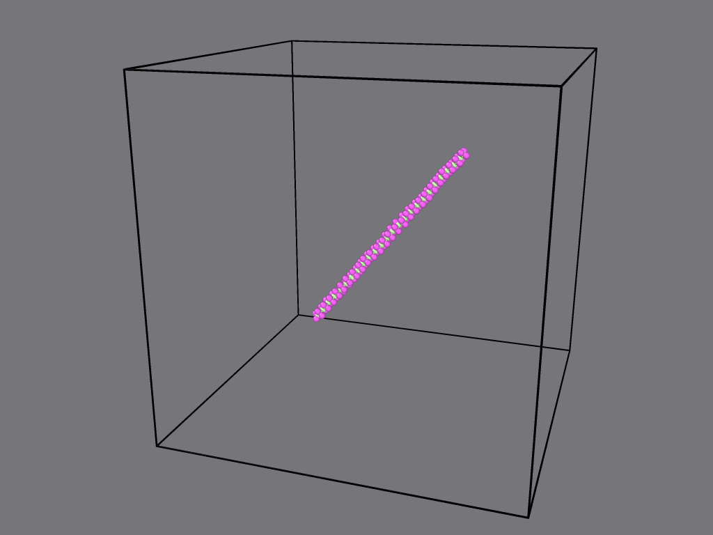

Thank you so much! I am using the 64bit 2Apr2025 version. As you said, I added extra settings to solve the error. At the beginning, I created several testing files and during that procedure, I must’ve been uploaded some other faulty code which it wasn’t for my “exploded” molecule.
