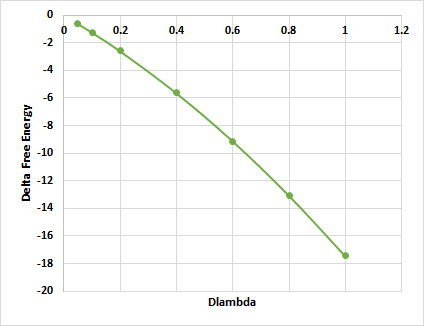

However, the FEP calculated on one of the clusters shows the following trend (other clusters show the same trend):
Since all the FEP calculated are negative value even when the lambda = 1, there is no optimum charge can be deduced.

The way you are doing it, you are changing the charges of the clusters between 0 and their original charge. Based on your data, it appears their original charge is the optimum. If this is somehow not what you expected, then either what you are doing is not actually what you are doing or your expectation is not correct. I can imagine that if your cluster is charge-stabilized, i.e., U_{charged} < 0, then the “ideal” configuration would be to have charges of infinite size, and hence there is no local optimum in the charge. If that is not the case, read on.
A basic and therefore stupid question: You did run the simulations for different values of lambda right? I found the literature to be quite decent when I dealt with it, I cited the following two articles because I applied Bennett’s acceptance ratio but I remember the Mezei papers to be quite good too:

As for your point of perturbing charge vs. perturbing potential energy:
Typically the potential energy is perturbed, but you can think of a charge perturbation as a potential energy perturbation if you rewrite your potential energy as:
U_{total} = U_{non-charged} + U_{charged} and then rewrite U_{charged} as
U_{charged} = \sum_{i=1}^N\sum_{j=(i+1}}^N q_i q_j (other stuff) -->
U_{charged}(\lambda) = \sum_{i=1}^N\sum_{j=(i+1}}^N (\lambda q_i) (\lambda q_j) (other stuff) = \lambda^2 \sum_{i=1}^N\sum_{j=(i+1}}^N q_i q_j (other stuff)
= \lambda^2 U_{charged}(\lambda = 1}
So in essence you are applying the perturbation
U_{total}(\lambda) = U_{non-charged} + \lambda^2 U_{charged}.
