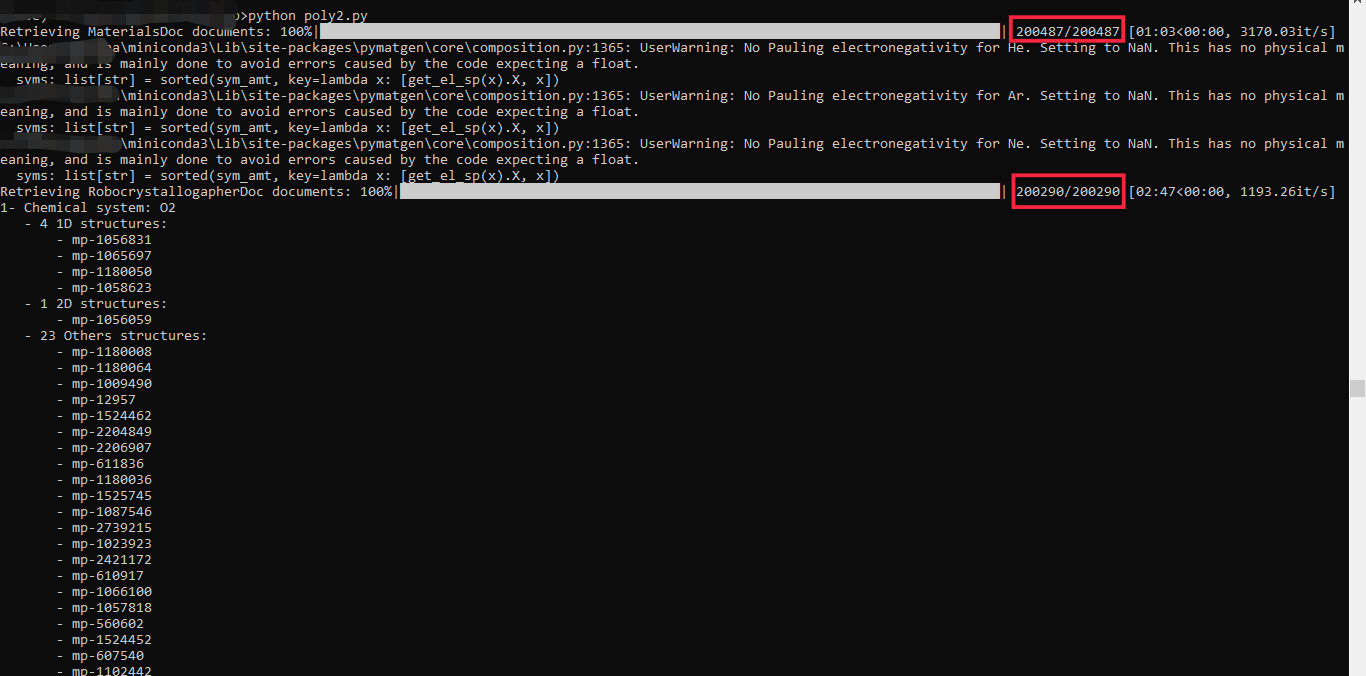

It seems that there are 155 chemical systems with 1D, 2D, and “3D” polymorphs in the Materials Project database. I would appreciate it if you could confirm this number, just to ensure I haven’t made any mistakes.
However, as shown in the attached image, the number of Materials Project documents does not match the number of the description documents generated by Robocrystallographer. It appears that 197 descriptions are missing, which would otherwise be generated by Robocrystallographer.
We don’t generate robocrys descriptions for every material - sometimes robocrys can’t identify a prototype, or something goes wrong in determining nearest neighbors
