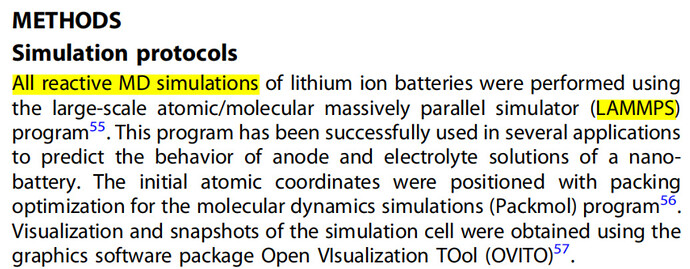

Does LAMMPS support e-Reaxff developed by Prof. van Duin group? He replied that they don’t use e-Reaxff in LAMMPS. So this may be the problem of the compatibility of e-Reaxff in LAMMPS. However, I saw someone use e-Reaxff in LAMMPS, in their paper. Did they misuse the e-Reaxff in LAMMPS?
Without knowing what e-ReaxFF is, it’s hard to help you, but my first guess would be that LAMMPS does not support it (anything supported in the official code is documented in the official documentation).
Many modified versions of LAMMPS and unofficial add-ons exist, both online and offline; you should directly check with the authors (of the “e-ReaxFF in LAMMPS” paper).
EDIT: looking more carefully at your screenshots, it looks like they trained their ReaxFF parameters against the data of the e-ReaxFF paper – not necessarily that they used the e-ReaxFF method itself. Whether that is physically valid or not is a discussion about ReaxFF, not LAMMPS :slight_smile:
For reference, e-ReaxFF models explicit electrons. No, public LAMMPS does not yet support e-ReaxFF, only ACKS2.
