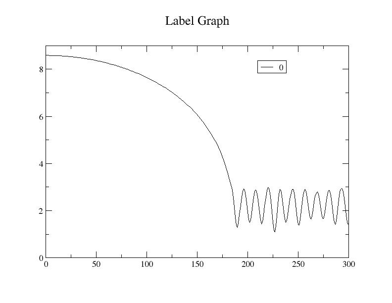

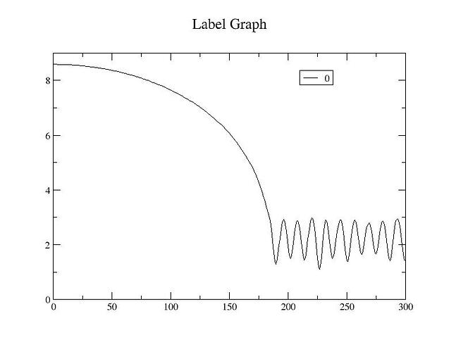

Ciao Axel,
i attach to this mail the input files for a very small system. The problem seems to be the same
also in this trivial case.
Grazie a te
Ciao Ciao
in.debug (885 Bytes)
data.debug (416 Bytes)
Ciao Axel,
i don't really see the problem here.
if i dump the coordinates more frequently
it becomes evident what is happening and
it makes perfect sense to me:
the "test particle" gets closer to the surface
and at some point gets "captured" by that
particle and the LJ interaction is replaced
by the bond as requested in fix bond create.
also you set up that atom type 1 can have
only one bond and will be changed to atom
type 2, whenthat maximum is reached, and
that happens as well.
after the bond is formed, the kinetic energy
in atom 1 results in strong harmonic vibration
of the atom due to the bond and also some
rotation around the captured particle, which
seems to be directing it so that i does the
rotation along the diagonal.
so far, i cannot detect anything that is not
like i would expect it from the documentation.
Ok. I have interpreted wrongly the documentation since
i understood that the original pair interaction, between the captured
particle and the capturing one, had to survive.
Thank you
Ciao
Michele
