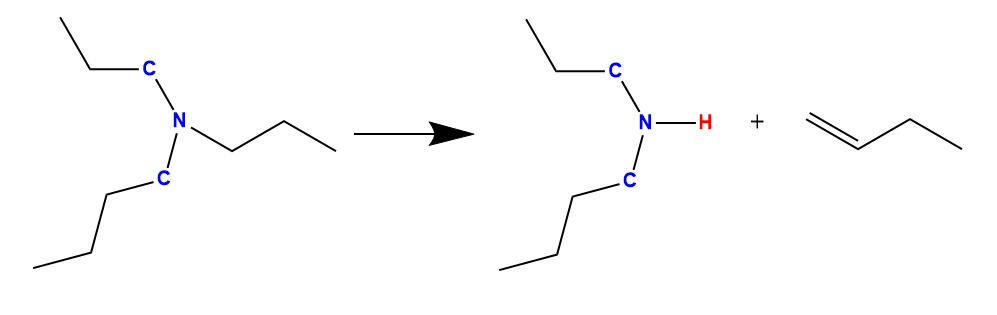

I try to implement the reaction below:
In the course of reaction a new atom must be created (red hydrogen atom). I identified a molecule fragment as shown in blue (frag1) in the post reaction template. I want the newly created hydrogen atom to be created in relation to this fragment, not the whole molecule template. So, I am using “modify_create” with below fix:
