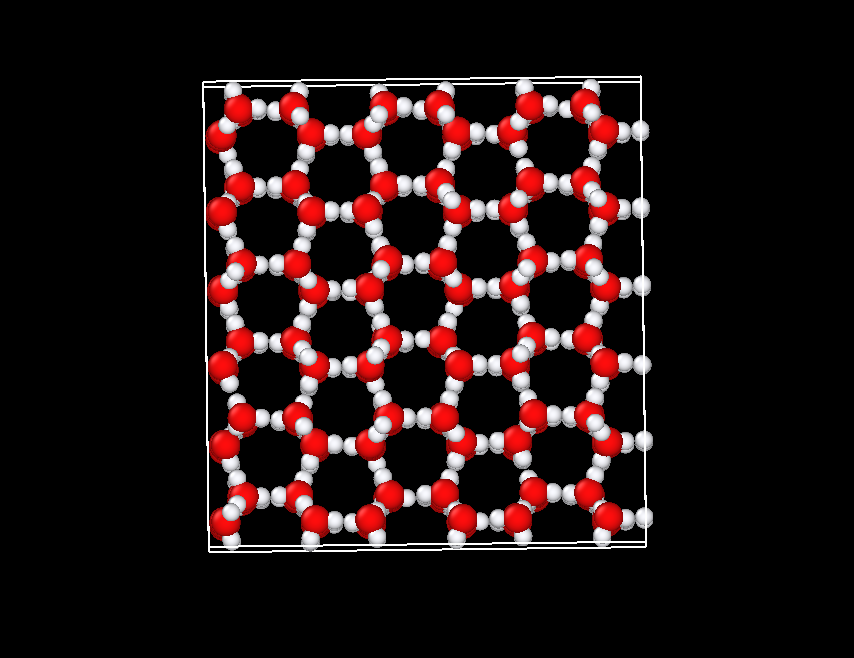

That means you have defined a rigid body with atoms that are far apart.
This is usually a problem with your geometry, for example when you have atoms in the rigid body that are on the “other side” of the box due periodic boundaries.
This cannot work unless you assign the suitable image flag values to those atoms.

I looked at my box after your comment (the image is attached) and I noticed that there are hydrogen atoms are on the “other side.” You mentioned suitable image flag values, how do I assign them? If you can provide me with a resource to explore this that would wonderful.

Image flags are explained within the LAMMPS manual in several places.
Since you read your initial configuration from a data file, the simplest approach would be to add them to the Atoms section of the data file. See the read_data documentation.
