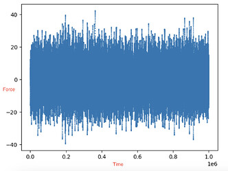

Firstly I would like to give a context for my simulation. I am trying mechanically unfold a polymer of 100 beads using fix smd and colvars(for testing purpose). I have fixed one end of polymer by excluding the bead from time integration. Now I want a force extension curve for the polymer. fix smd has 7 output where I can get a component of force as well as the magnitude of force. I am doing a constant velocity simulation with a velocity of -0.0001 and the spring tethered at (100, 0, 0). Now when I plot the force acted on the atom attached to the spring. I get the following plot.
When I change the x-axis scale i see a pattern in force over time.

  1. Is this behaviour of force normal as in, is this supposed to be in this way, in a pattern? I understand that the force applied is by a spring. But I did not expect force like this. I have performed simulations by adding a external force at one end of polymer and equilibrating it. (The force is added every timestep). I expected the general trend of force to increase over time.
