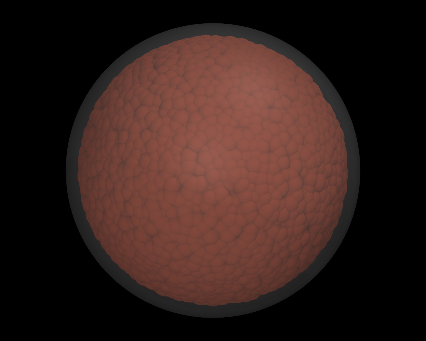

I just did a quick check with just one LJ atom type and a containing sphere using pair style lepton for the sphere. Seems to be working as expected. Note that you need to adjust the neighbor list “one” and “page” settings because the confinement sphere has to have all contained particles as neighbors.

Just run the code above:
