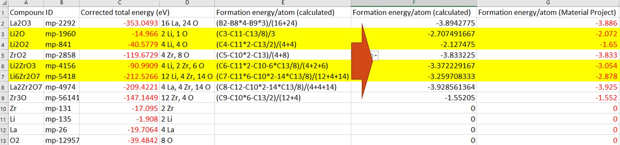

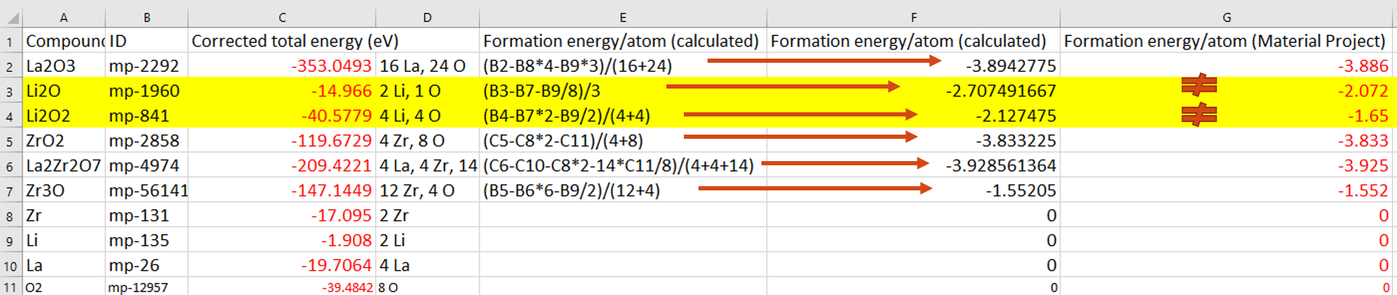

I have question related to the formation energy calculation. I find some inconsistency between formula calculation and Material Project value for several compound such as Li2O, Li2O2, as shown in the figure. Could you please help to verify which values is exactly?
The following is the updated table.It seems to me that the compound related to Li has problem with inconsistency formation energy. Or did I made some wrong calculation? The “red” values are taken from Material Project.
