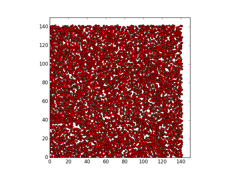

Dear Stefan,
Thank for your reply. I had been thinking of the things that you questioned about before I asked my questions.
Following what you suggested, I have modified the script as it is shown below, and I attached a snapshot photo of the time-step 1000 which is the last time-step in the simulation. The number of circles generated in the photo is 5751.
However, the circles still overlaps. !!!
Could you please tell where the problem is ?.
My aim is to generate non-overlapping circles with packing fraction 70%, and my idea to achieve it is the following script using the pair_style zero where there is no interaction between circles.
using pair style zero makes no sense. if particles have no interactions, they can move “through” each other without a problem.
as stefan was pointing out already, LAMMPS will do literally what you ask it to do, it doesn’t care about real life physics, only the rules that are programmed.
for the same reason, if you have, say, a Lennard-Jones interaction, the diameter of the particles will be completely ignored, since that property never enters anywhere into the potential energy function.
now for some productive suggestions. the easiest and most reliable way to get a system of a given density, is to generate a regular lattice. then you can compute ahead of time what the spacing between particles has to be. if you want to make it less regular, you can then “shake it up” by assigning (large) random velocities (if need be multiple times) until you have something reasonably random and mixed. of course, you will only avoid overlaps between extended particles, if you use a pair style, that takes the diameter/radius into account, e.g. from the GRANULAR package. please also keep in mind, that LAMMPS’s architecture, does not - in its current form - support hard sphere (or hard disk) models.
