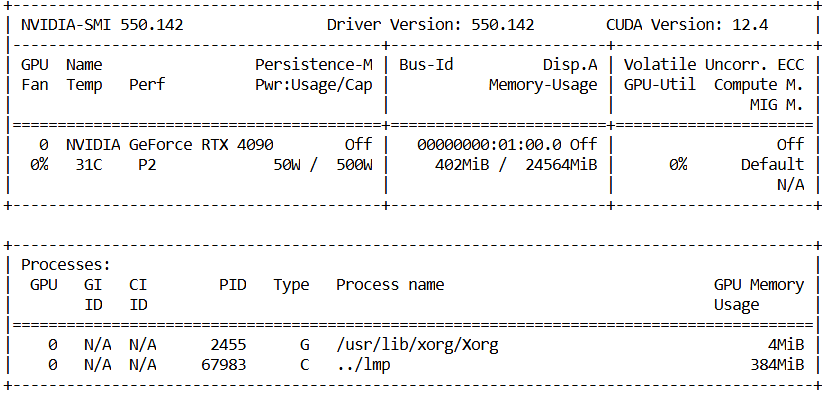

There is no error and the GPU Util is very small, as can be seen below.

Not all pair styles have GPU package support. Whether this is the case can be seen in the documentation of the individual pair style (is there an accelerated entry with a /gpu suffix?) or in the overview of all pair style (is there a “g” in the parenthesis indicating accelerated versions?).
If you want GPU support for MEAM, you need to install the KOKKOS package for CUDA GPU support and compile LAMMPS accordingly.
