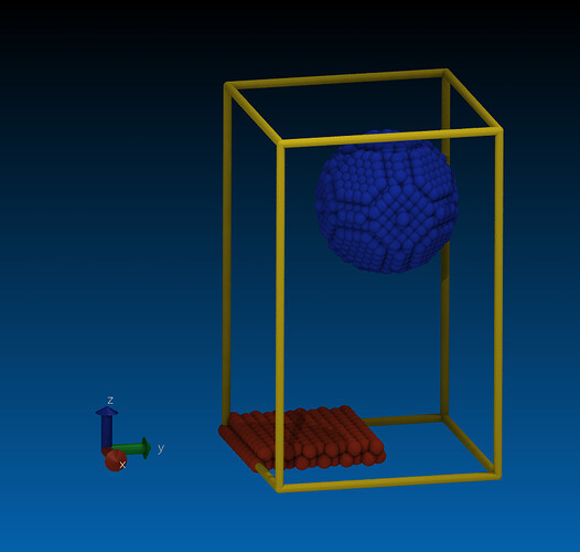

I am trying to simulate C60 buckyball impact on graphene sheet. When i run my script its getting stuck after defining lattice parameters. I have attached the relaxation script below. Kindly help
this is due to the *EXTREMELY* inefficient way how you define your
simulation cell: you define a *GIGANTIC* (periodic) cell (which will
lead to *EXTREMELY* inefficient parallelization) for no good reason.
you can achieve the same effect much better by simply not using
periodic boundaries (and without having to fear losing atoms) with
"boundary m m m" and then you can define your simulation cell to just
barely contain your created atoms, e.g. as:
region box block -1 16 -1 16 -1 26
the reason, that LAMMPS gets stuck is because it iterates over all
grid points in the *ENTIRE* box (which are of the order of 10**20) to
fill two comparatively *TINY* regions. this nested loop will take a
very, very long time.
that said, your create_atoms commands create neither a graphene sheet
not a bucky ball as evidenced by the attached snapshop.
