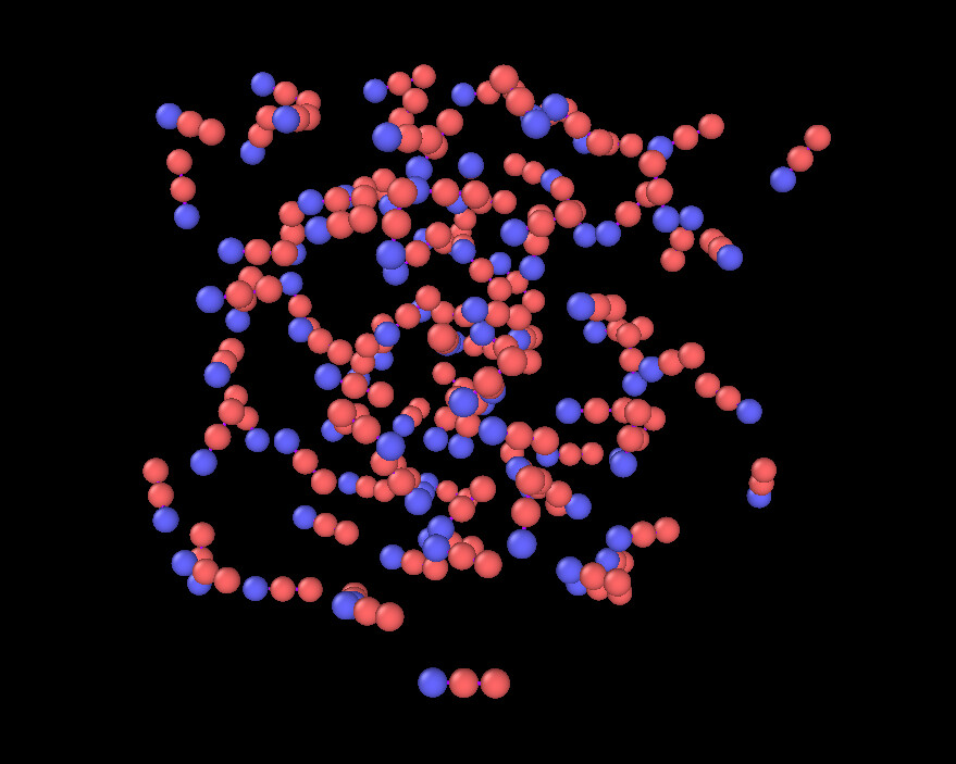

I want to construct a linear polymer (LJ unit, FENE model, no angle) using fix bond/react. To simplify the system, I initially pack many short molecules of the form type 2–1–1 into the simulation box. My goal is to use fix bond/react during the simulation to form a linear polymer, where type 2 beads form the main chain and type 1 beads act as side chains.
The intended structure looks like this:
2–2–2–2–2–2–2–2–2
1 1 1 1 1 1 1 1 1
1 1 1 1 1 1 1 1 1
I’m not sure how to properly define the templates and reactions for this process in fix bond/react, and would greatly appreciate any advice or example input files that could help.
blue bead is type 2 bead, orange bead is type 1 bead
