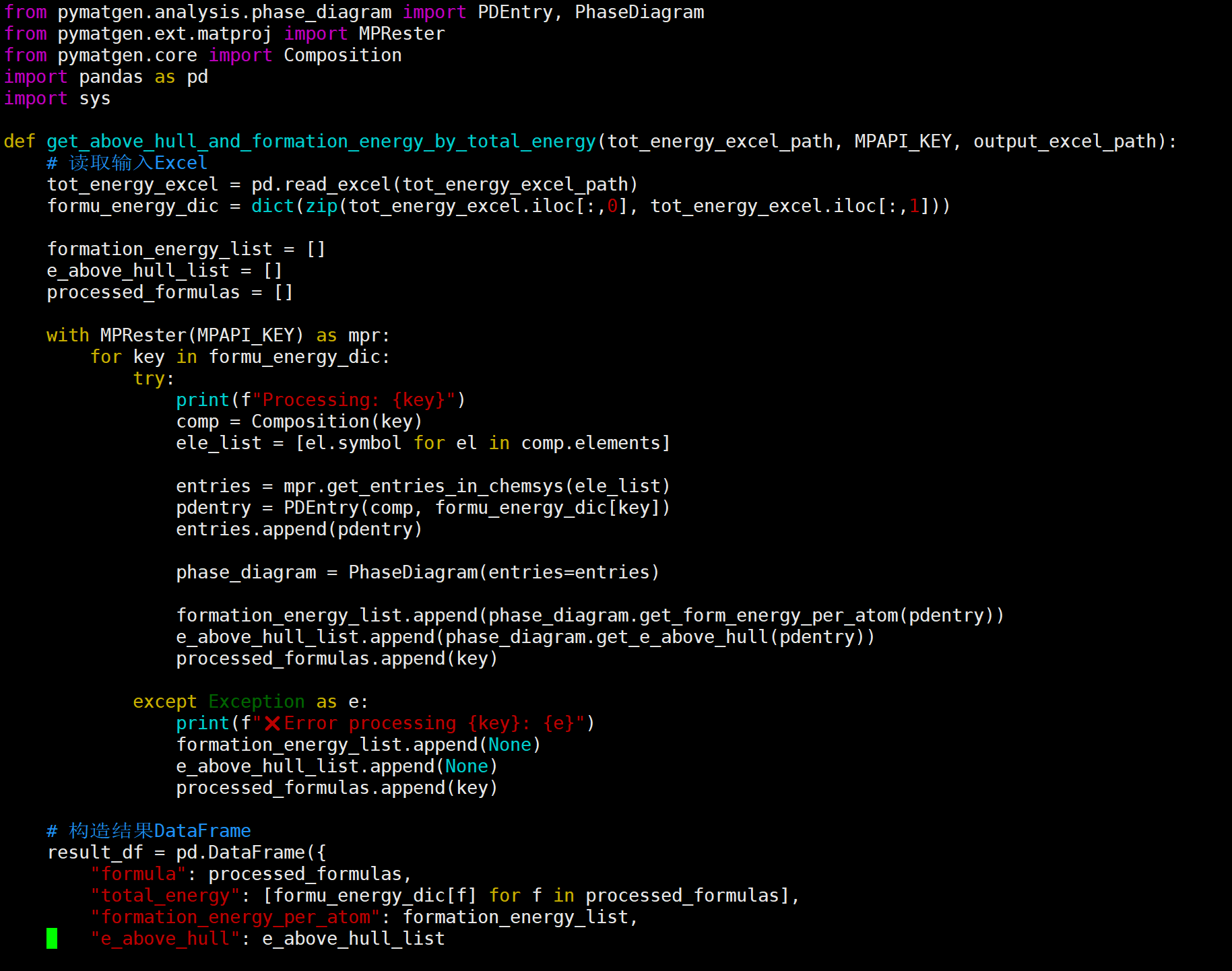

I’m currently working on calculating the energy above hull (Ehull) for a custom compound using the phase diagram module in pymatgen
. I used DFT total energies from my own structure relaxations (VASP), and constructed the phase diagram based on the relevant chemical system.
However, I noticed that the Ehull values for my compound are consistently around 0.3–0.5 eV/atom, which seems unusually high.
I also tried using the total free energy values reported in the literature as input for the phase diagram construction in pymatgen
, but the calculated Ehull values still don’t match those reported in the paper.
Any suggestions on how to reduce this discrepancy or debug this issue would be much appreciated!

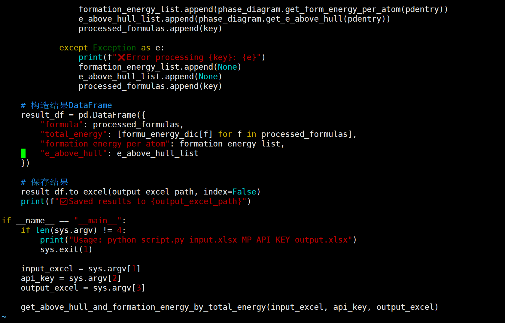

this is my code,
Thanks in advance.

If you use spglib or pymatgen to get the space group of the material, e.g.:
from pymatgen.core import Structure
for file_name in ("POSCAR","CONTCAR",):
print(file_name, Structure.from_file(file_name).get_space_group_info())
do you see that the expected P21 / c symmetry is respected before and after relaxation?
To build the phase diagram, are you using entries you computed yourself for the unaries and other composite phases? Or the entries from Materials Project / mp_api?
