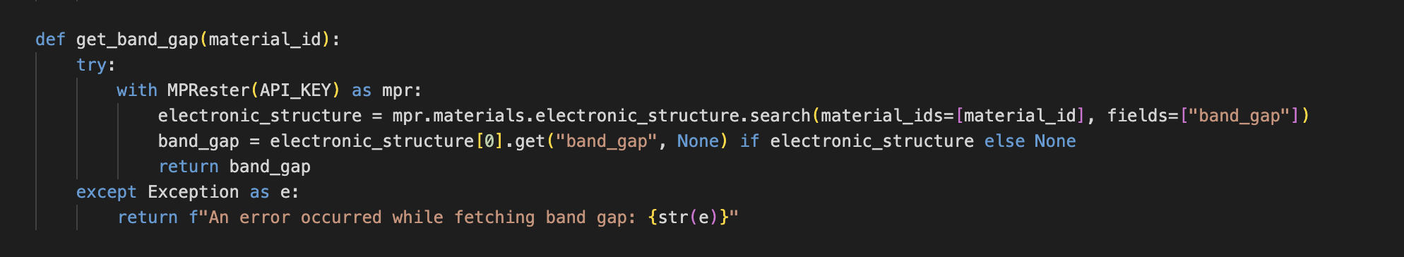

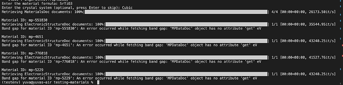

I’ve tried doing it this way using the api. Can you please let me know if I’m going in wrong direction ?
@Yuva_Sri_Vemulapalli this will do it.
with MPRester(your_api_key) as mpr:
    docs = mpr.materials.summary.search(material_ids=[material_id], fields=["band_gap"])
    band_gap = docs[0].band_gap
– Jason
