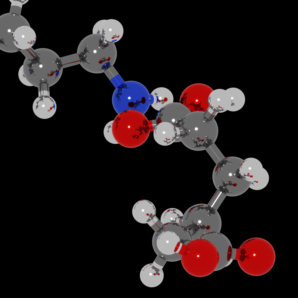

This is, of course, highly subjective. However, the various rendering engines in OVITO offer different settings that may help you achieve your desired visual style.
If you’re looking for more reflective or metallic-looking particles, we’ve recently added support for more metallic materials in a development version of OVITO Pro:
You can download this development version of OVITO Pro from the links below:
