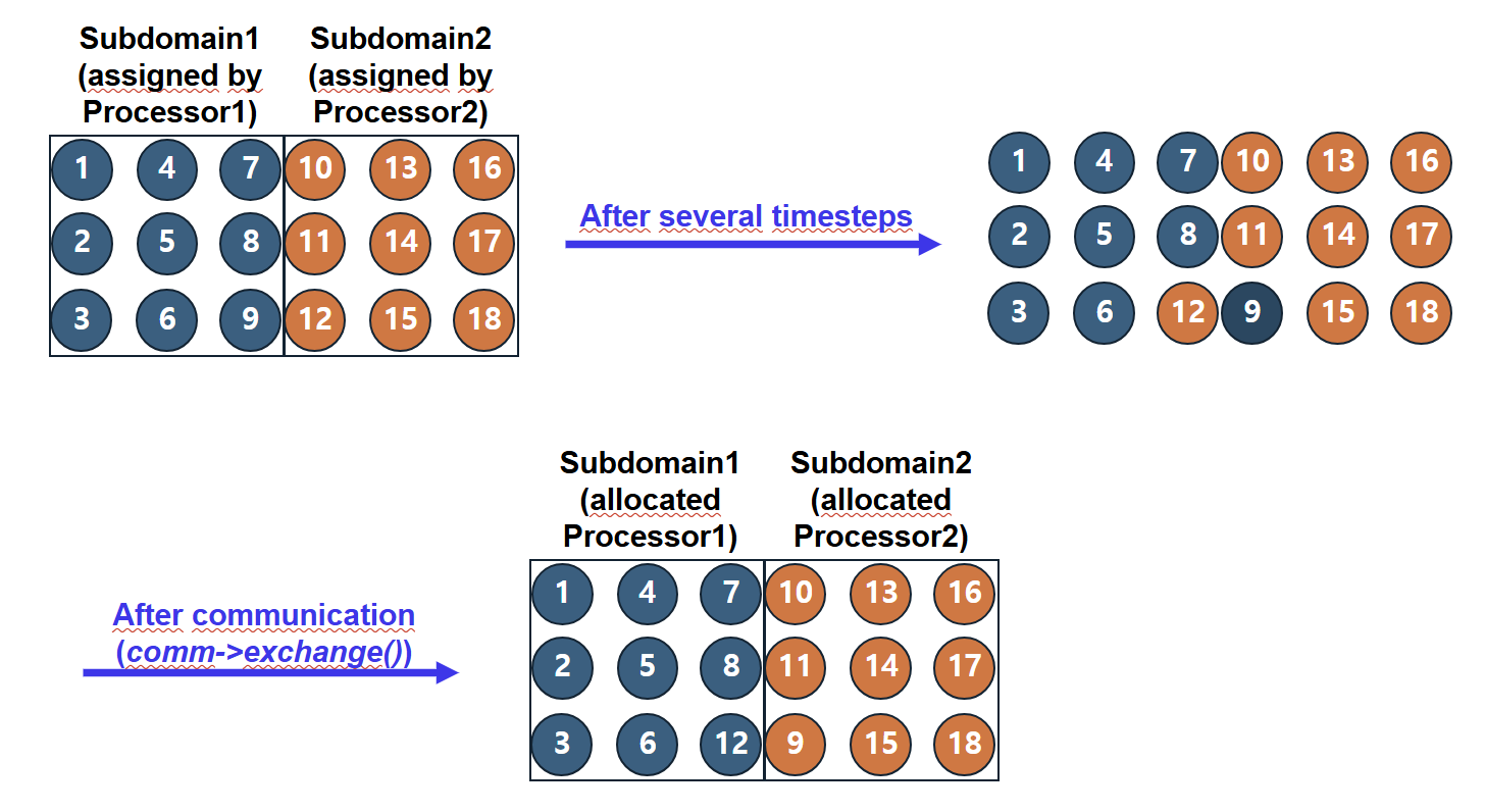

However, I still have a question about the statement “communicated to the neighboring subdomains (in 6 steps: left, right, top, bottom, front, and back) in comm->exchange()” in your comment.
First, the figure below shows the communication process for exchanging atoms between neighboring subdomains, as I understand it. The blue atoms are owned by Processor 1, and the orange atoms are owned by Processor 2. After several timesteps without re-neighboring, one of the blue atoms migrates to the neighboring subdomain region, and one of the orange atoms also cross into next region. Then, during the exchanging process, the orange atom (indexed as 12) becomes an owned atom of Processor 1, and the blue atom (indexed as 9) becomes owned atom of Processor 2. This represents my understanding of the communication process for exchanging atoms. Is this understanding correct??
If so, I believes that the a subdomain should communicate with 26 neighboring subdomains in 3D. In addition to the six direct neighbors (left, right, top, bottom, front, and back), this includes diagonal neighbors (upper left, lower left, etc.) to account for atoms that move across subdomain boundaries in diagonal directions. I’d like to humbly ask for your opinion on this.

Please study the recent LAMMPS paper or Parallel algorithms section of the LAMMPS manual.
Only six exchange communications are needed for the regular “brick” decomposition style communication pattern. More exchanges are only required for “tiled” decomposition.
Thank you. With your comments and some additional study, I now have a complete understanding of how the lost atom issue occurs in LAMMPS. Have a great day!
Kevin
That is great. With that level of understanding, you can now help others that are asking here about lost atoms or similar.
