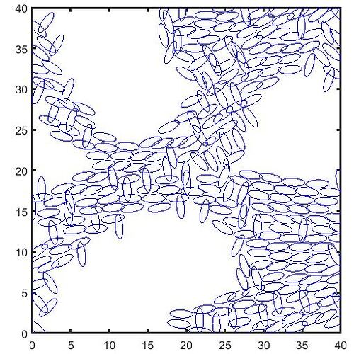

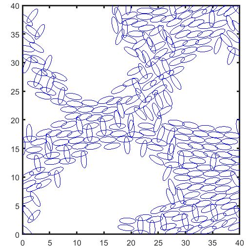

When I simulate 2D ellipsoidal in LAMMPS, the particles usually appear to overlap just like in the figure.

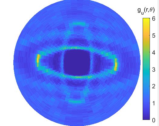

and the distribution function also show the overlap,
I try to change different parameters in gay-berne potential, but failed.
So, I wonder there is any tips when we apply gay-berne potential to avoid the overlap.
Thanks a lot!
