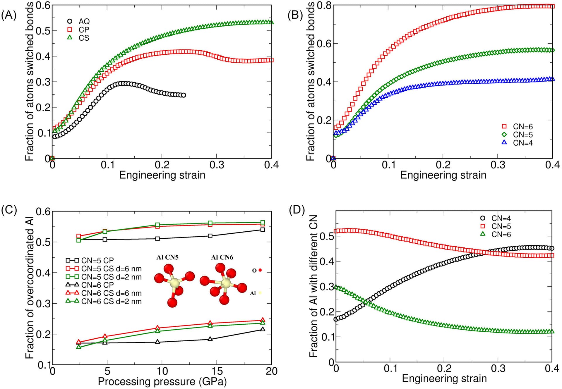

I am try to compute the curves of fraction of Al experiencing bond switching events during deformation in amorphous alumina.
Please see the paper, as an sample- Tensile ductility and necking in consolidated amorphous alumina, Figure 4 (B).
