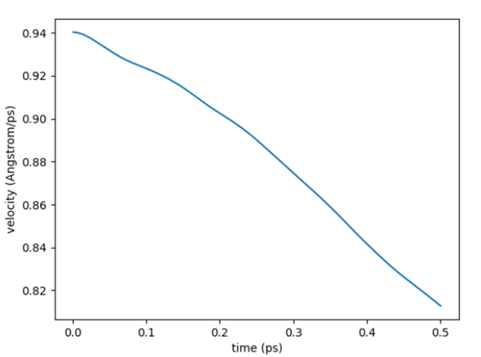

In the following script, we mimic such an operation in a pristine Fe bulk system. The initial velocity is given a large value (i.e., variable v equal 1), and only the x component of the velocity of the COM of the upper layer is controlled. However, it is found that although the fx acting on the COM is almost zero (in the order of 10E-17), the x coordinate of the COM does not change linearly with respect of time. This means that the velocity of the COM of the upper layer is not controlled.

This is the excerpt of upper_com.txt, which contains the position (uppercom_x) and the fx of the COM (com_fx_upper). The velocity of COM is not kept at initial velocity.

Fix smd can do what you ask for.
