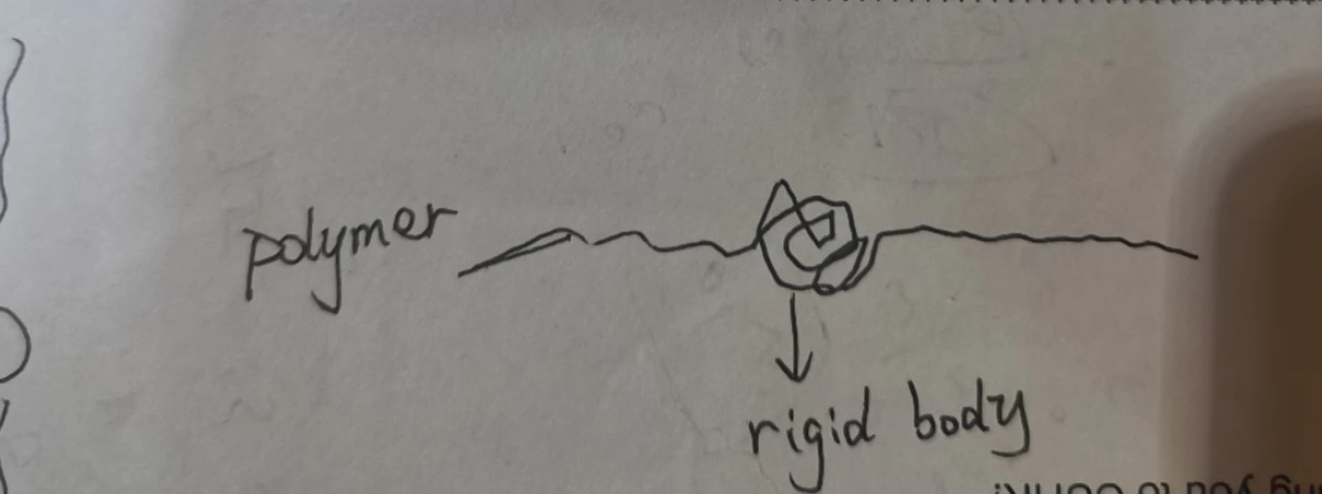

I need to make the center region of each polymer(40 in total) be a rigid body, which is approximately 30 beads long, and let the other part( on the two sides of the center region) flexible. Initially, I was trying to create groups and then “fix rigid” them, but it’s impossible to have 40 different groups in lammps and I cannot use “molecule” to definite rigid body since I want to leave part of each polymer flexible.
The schematic diagram is below:
I do appreciate for any help!!!
