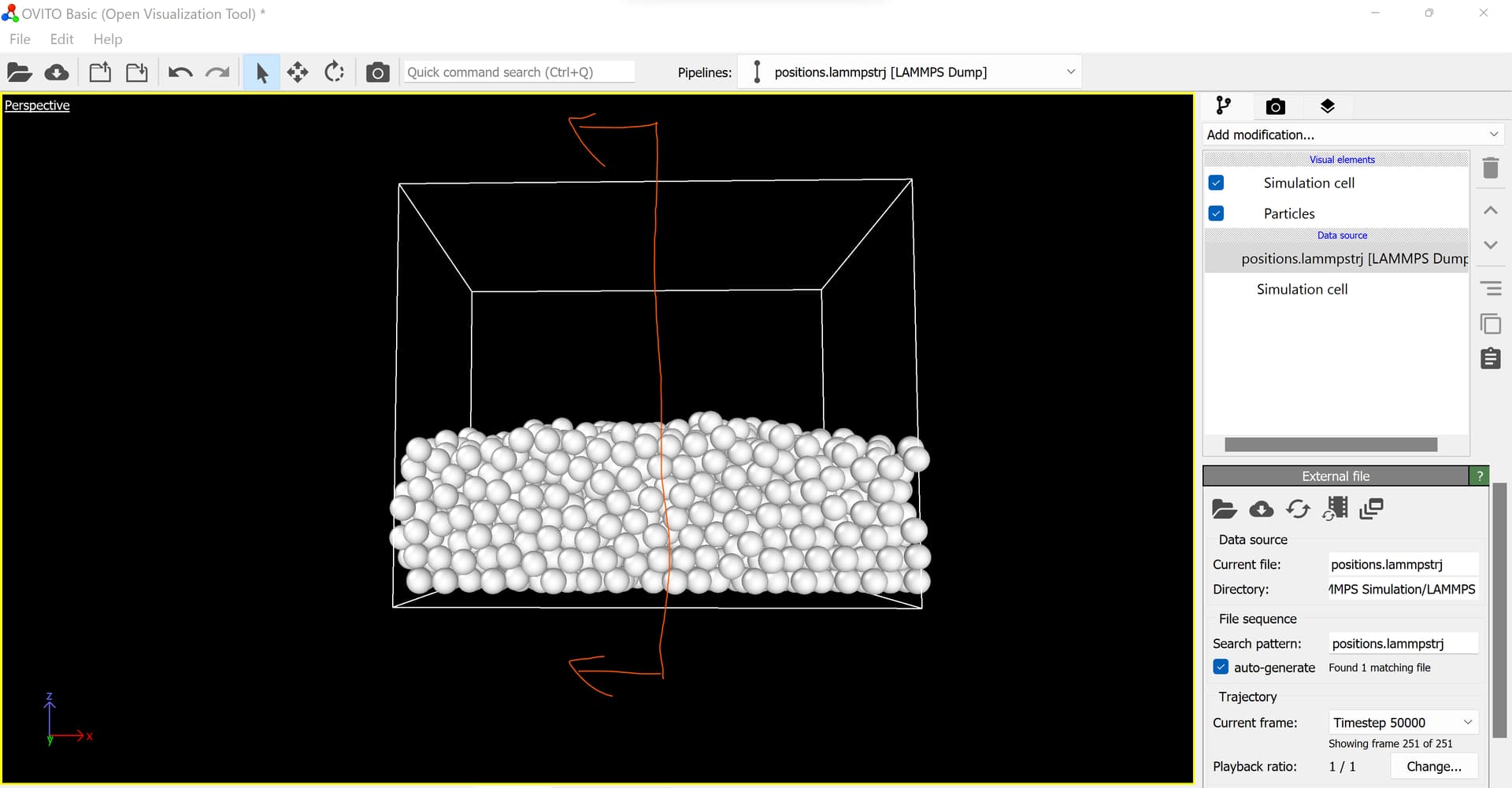

I want to delete some atoms from a simulation box, I was working with the LAMMPS granular modules. The code is shown below.

But no atoms are deleted from the simulation box. May I get any idea of how to delete these atoms?
I am also attaching a screenshot of my desired atom deletion.
You are trying to delete atoms before any are added to the simulation box. How could that work?
Dear Professor Akohlmey,
I have used the fix pour command to pour granular particles in the simulation box. Then I have created a region (‘region void’) and trying to delete atoms within that region.
Please read the description of the fix pour command in the manual carefully and also observe your output.
My statement is correct and yours are not.
Thank you for the suggestions; I have figured out the problem. After unfixing the pour command, it worked.
